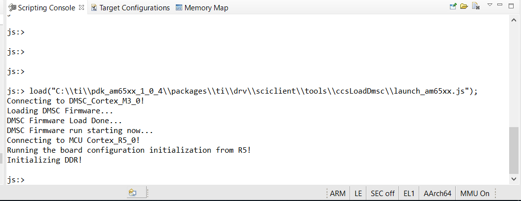

    No, my case has "SEC OFF", see the screenshot.
    The boot pin setup doesn't matter.
    My board is also Rev E3,  3P0014.
    Most likely, you used the GEL to initialize the board only WITHOUT loading DSMC firmware. You need to do this following:  ,
    Topic:
    Description
    AM65x EVM users testing basic functionality like R5F and A53 bring up and DDR configuration can use the basic setup described in the previous section for setting up the EVM. However, advanced application level debug that uses resource management for UDMAs, interrupt setup, power management to setup clock modules, or wakeup/power of slave cores will require loading of SYSFW (DMSC Firmware) on the M3 core so that the application can make API calls to leverage its services.
    Regards, Eric

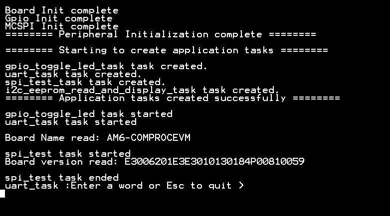

  • Hi Eric-san,
    Thank you for your reply.
    The demo succeeds in the case with loading DSMC firmware, but fails in the case without loading DSMC firmware. My above post is the results in the case without loading DSMC firmware.
