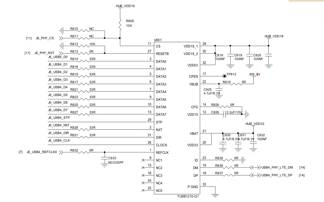

Hello Ti,
I want to use usb4 to connect a mouse or udisk, but the the system cann't recognition.
My custom board usb4 connect tusb1210, and usb4 is external VBUS,and i use 6ao1.1 sdk.
device tree config:
omap_dwc3_4: omap_dwc3_4@48940000 {
	compatible = "ti,dwc3";
	ti,hwmods = "usb_otg_ss4";
	reg = <0x48940000 0x10000>;

I configurate tusb1210 related io/clock, and I measuring REFCLK/CLOCK is 19.2M and 60M.The ID pin is low
The kernel detected the usb4 port:

The usb mode is host:
jacinto6evm:/ $ cat /sys/kernel/debug/48950000.usb/mode
host
My schematic diagram:
What did I do wrong?Do you have any suggestions?
  • Hi Haili,
    Have you enabled tusb1210 driver as mentioned here : www.ti.com/.../TUSB1210SW-LINUX
  • Hi Dwarakesh R,
            Thanks so much for response,
            I've already tried to use tusb1210's driver,but kernel cann't working   normal.
           log:

            Can you share devices tree configuration?
           For example:
    &usb4 {
    dr_mode = "host";
    snps,hsphy_interface = "ulpi";
    status = "okay";
    phy {
    compatible = "ti,tusb1210";
  • Hi Haili,
    Now that PHY is tusb1210 and not TI PIPE3, can you remove the following two entries and check, from device tree:
            phys = <&usb3_phy1>;
            phy-names = "usb3-phy";
