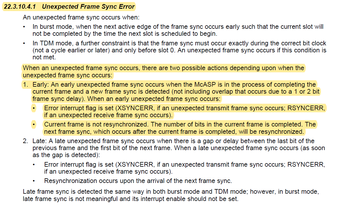

Hello together,
I have a question to the TDM mode form the McASP-Unit in the AM335x processor.
In the TRM is described, that the TDM sequencer counts the slots beginning with the frame sync signal.
What happens, if i have for example 4 slots, but after 2 slots, there es i a new frame sync signal?
Restarts the RSLOT-register again with zero, if this happens?
Thank you for your support.
