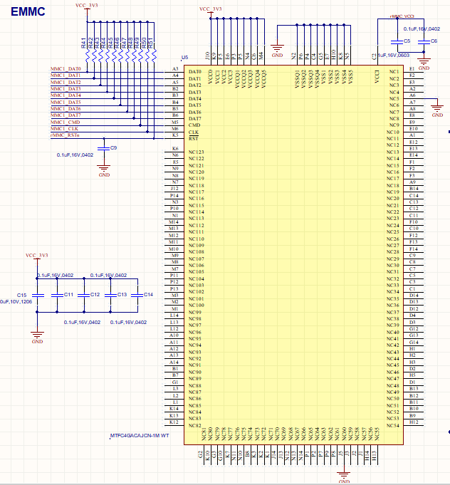

Anyone used MTFC4GACAJCN-1M WT on AM335x as boot device before?
One customer use it can't boot.

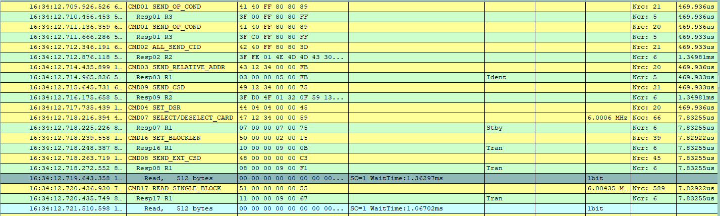

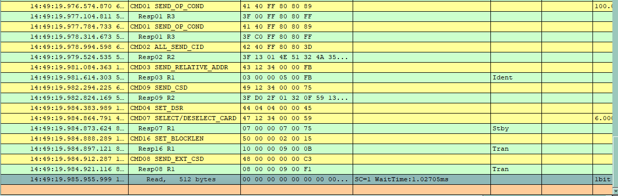

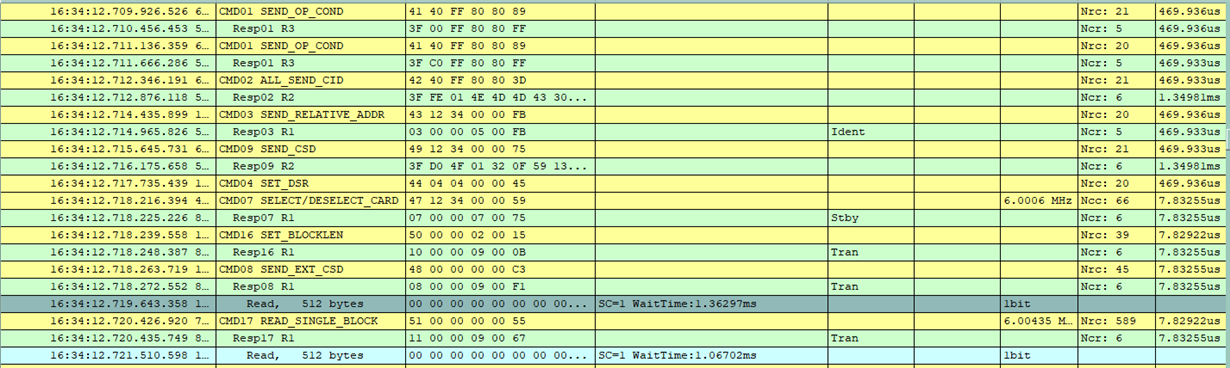

Customer: Captured with logic analyzer, found AM335x ROM did not response after eMMC response CMD8 with EXT_CSD data.
