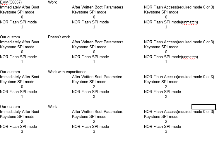

Next step, I burned the FW to nor flash on our custom board. I confirmed that correct data were burned on the flash on my FW(using nor flash reading funtion).
I switched boot mode to "SPI Boot" mode, and I confirmed that C6652 was certainly driven as "SPI Boot" mode.

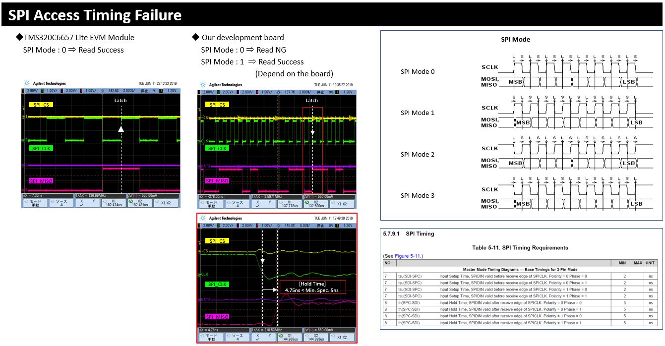

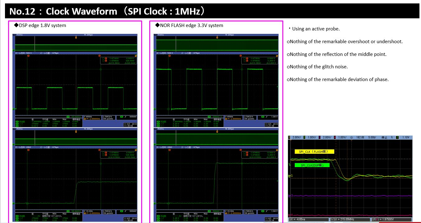

However, C6652 didn't boot. I already checked as follow.
1. "SPI interfaces" signal integrity is good.
2. MISO line seems to receive data from flash device, but CS0 doesn't go up forever.
3. nysh.spi.map configuration is no problem, I think. please confirm the attached.
4. I updated parameter of DDR3 Configuration in the "emif4Cfg" structure. Please confirme the attached.
I don't understand why CS couldn't be going up.
What is the cause?

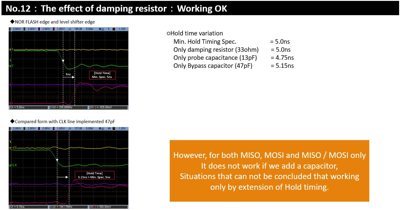

    I think that has multiple problem as SPI communications.
    1. It doesn't work as spi mode 0 or 3.
    I confirmed that our using flash is compatible to spi mode 0 or 3.
    our using flash is MT25QL128ABA made by Micron and this device is upper compatible to N25Q032A(on EVM).
    However, changing spi mode to boot as spi mode 1 or 2, DSP correctly booted.
    Why does this happen? Both of those flash are compatible to same spi mode, nevertheless,  there is obvious difference to boot.
    2. About SPI CLK integrity
    At the begining, I told you that spi clock integrity is good and it seems that now I still think so, but probably clock waveform has something problem.
    If our hardware team implemented a capacitor or a damping resistor, changing spi mode to 1 or 2, DSP could boot.
    Influence of a capacitor or a damping resistor has the effect of delaying hold timing, however this effect applied only to clock line.
    Even if those implemented to MISO or MOSI, however hold timing is extended, boot is failure.
    Please confirm the attaced. This is our added investigation. give us your support.

    Here is the response from our hardware expert,
    I was not able to clearly determine whether this was a hardware issue or a software / configuration issue. Therefore, without understanding the root cause, I would not recommend adding a capacitor to the clock line as a solution.
    I believe he indicated that he could reliably write and read the FLASH from CCS. You need to make sure that this is clearly confirmed before moving on to the next part of debugging this issue. Also, compare the dump of PLL and SPI port configuration during this robust operation and its failing.
    Thank you.
  • Hi Raja,
    Thank you for new information.
    After our research, I probably understood what is cause.
    For SPI Controller in Keystone, general spi mode 0(adoptive to NOR flash too) means Keystone's spi mode 1.
    And our custom board's default boot strap status to be applicable spi mode is 00(this means Keystone's spi mode 0).
    On the other hands, Micron NOR flash is compatible to spi mode 0 or 3(Keystone's 1 or 2).
    Therefore, the sequence of DEVSTAT register probably work as the follow.
    Therefore I think that our custom boards are working as spec however doesn't understand why EVM work as above. this fact confuse me so much.
    regards,
  •  For SPI Controller in Keystone, general spi mode 0(adoptive to NOR flash too) means Keystone's spi mode 1. On the other hands, Micron NOR flash is compatible to spi mode 0 or 3(Keystone's 1 or 2).
    I am confused. As you said earlier, flash supports SPI mode 0 and 3 which is "Input data is latched on the falling edge of SPICLK" and in keystone also SPI mode 0 and 3 are same. Please look at below boot parameter table from C6652 data manual.
  • Hi Raja,
    I report the final result of our research.
    Please confirm my reply at Jun 12, 2019 1:47 PM.
    What I always say "general spi mode 0" is "Input data is latched on the rising edge of SPICLK". This is the common to Micron flash however, only TI device is different from this in this case.
    Actually, our hardware team confirmed that "TI's spi mode 1" works as "general spi mode 0" from its spi clk timing.
    One thing I couldn't understand yet is why "TI's spi mode 0" works with "general spi mode 0(Micron is compatible)" on the EVM.
    I consider that if working different mode for DSP, but being sufficient timing > 5ns, it works.
    On the EVM, It happened to be moving didn't it?
    regards,
