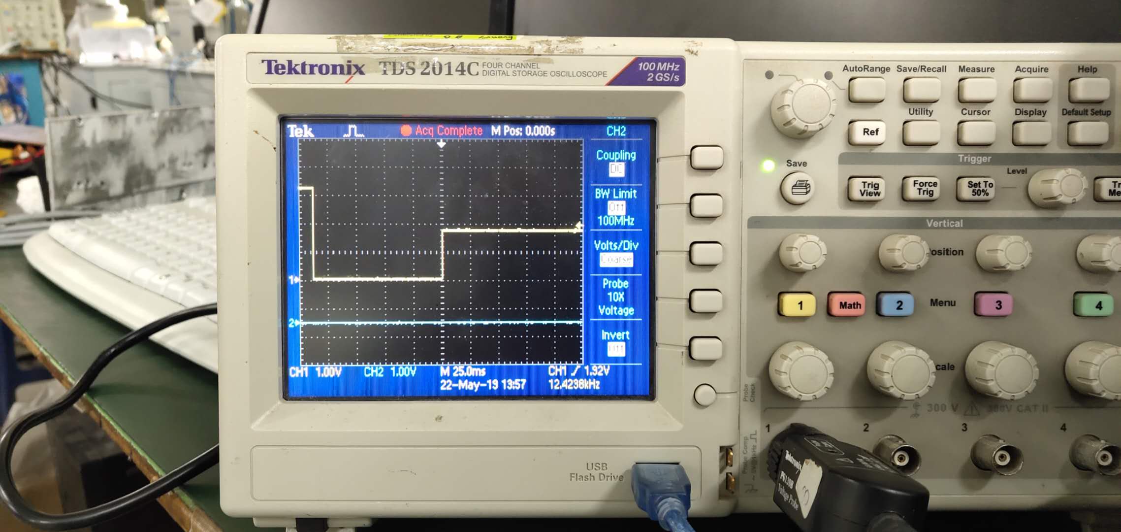

Hello , every time when I use
echo 57 > /sys/class/gpio/export
echo out > /sys/class/gpio/gpio57/direction
then the Gpio 's status(the yellow signal) changed .
Is that normal?
In my project ,this is not expected ,please help me.

  • Thanks for reply,Pavel
    I am not using PSDK Linux,
    because I am using EVM borad(which is also called bb_x15)
    cat /sys/class/gpio/gpio57/value
    the value is 0.
    I searched and found something in
    I think maybe I should use
    echo high > /sys/class/gpio/gpio57/direction
    in order to make sure the status of gpio57 won't change.

    From what I understand, gpio57 (yellow signal) is low (0) before you set the direction to output, and you need to stay low after that.
    For general direction, I can provide you below hints:
    - check if you have internal or external pull up resistor, that is making this signal high. Internal pull up is configured in CTRL_CORE_PAD_x [16] [17] bits
    - check what value you have in your GPIO_DATAOUT register, make sure you have 0 for gpio57. Check also GPIO_SETDATAOUT, GPIO_CLEARDATAOUT, and TRM section "27.4.8 General-Purpose Interface Data Input/Output Capabilities"
