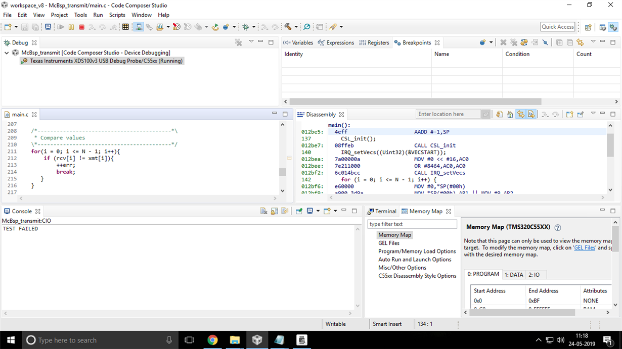

  • Hi Muneeswaran,
    Is the issue appears when receive on 5th channel and transmit to 9th channel or it can be reproduces with each other channel?
    Did you check result of CSL_McBSP_Interrupt_Example execution? If it is working on your board I suggest you to use this example for starting point and add your functionality there.
    Tsvetolin Shulev
  • Hi sir,
    i check that CSL_McBSP_Interrupt_Example. When am execute the example, i got TEST FAIL.
    any help to solve this problem.
  • HI,
    now test passed,when i modify
    for (i = 0; i <= N - 1; i++) {
    xmt[i] = 0x55;
    rcv[i] = 0;
    In previous , xmt[i] as ((Uint32)i << 17) + i;
    how this problem occured??
    any help
    When DLB =1, that program detects receive interrupt.
    When DLB=0, receive interrupt doesnot occur.
    anyother setting i need change?
    please share that information receive interrupt with DLB=0. Anyother example for Mcbsp in DSP5509 Development board?
    (transmit data to particular channel is success, but i stuck with receive side. help me to out. )
  • when DLB=0, i will connect DX pin to DR pin of Mcbsp.
    Is it correct? any other method to provide to read data??
  • Hi Mr.Tsvetolin Shulev,
    Its working fine. I didn't notice other parameter. Now i write to read and write data in multichannel it working fine.

    void main(void)
    	Uint16 i;
    	CSL_init();
    	IRQ_setVecs((Uint32)(&VECSTART));
    		xmt[i] = 0x55;
    		rcv[i] = 0;
    	old_intm = IRQ_globalDisable();
    	mhMcbsp = MCBSP_open(MCBSP_PORT2, MCBSP_OPEN_RESET);
    	rcvEventId = MCBSP_getRcvEventId(mhMcbsp);
    	xmtEventId = MCBSP_getXmtEventId(mhMcbsp);
    	IRQ_clear(rcvEventId);
    	IRQ_clear(xmtEventId);
    	IRQ_plug(rcvEventId, &readIsr);
    	IRQ_plug(xmtEventId, &writeIsr);
    	MCBSP_config(mhMcbsp, &ConfigLoopBack32);
    	IRQ_enable(xmtEventId);IRQ_enable(rcvEventId);
    	MCBSP_start(mhMcbsp,MCBSP_RCV_START | MCBSP_XMIT_START,0);
    	IRQ_globalEnable();
    	//while(1)
    		while(!MCBSP_xrdy(mhMcbsp));
    		//MCBSP_write(mhMcbsp,0x55);
    		//IRQ_enable(rcvEventId);
    		while (XfrCnt < 10);
    		for(i = 0; i < N - 1; i++)
    			if (rcv[i] != xmt[i])
    				++err;
    				break;
    		printf ("%s\n",err?"TEST FAILED" : "TEST PASSED");
    		IRQ_globalRestore(old_intm);
    		MCBSP_close(mhMcbsp);
    interrupt void writeIsr(void)
        IRQ_disable(xmtEventId);
        MCBSP_write(mhMcbsp,xmt[XfrCnt]);
    interrupt void readIsr(void)
        rcv[XfrCnt] = MCBSP_read(mhMcbsp);
        ++XfrCnt;
        if (XfrCnt == N)
            IRQ_disable(rcvEventId);
            MCBSP_reset(mhMcbsp);
        else
    Thanks for your support, help me to out the problem
