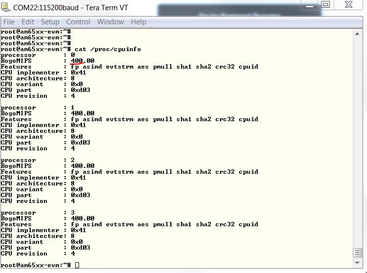

AM6548: CPU frequency
Part Number: AM6548
What is the BogoMIPs relate to CPU frequency?
I didn't find  $ cat /sys/devices/system/cpu/cpu0/cpufreq/scaling_available_governors in PSDK 5.03 of AM654x.
How to set CPU frequency?

  • Hello Tony,
    Update: we typically support changing the ARM frequency through cpufreq. At this point in time, cpufreq has not been implemented on AM65x.
    I am still looking into whether we currently support frequencies other than 800MHz for the ARM core in Linux. If we do, I will try to get a "suggested" way to make those frequency changes.
    Nick
  • Hello Tony,
    Final update: At the moment, TI Linux only supports running the ARM core at 800MHz on AM65x. I expect that this will also be true for the June/July SDK release.
    In a later SDK, we will add support to select the operating point (OPP) at boot time through the device tree (800 MHz, 1GHz and 1.1 GHz). I cannot promise a timeline right now, but it seems likely to be in the October SDK release or the December SDK release.
    At this point in time, I do not see a timeline for adding support to change the CPU frequency at runtime. If this is a critical issue, please reach out to me offline and I will add your information where we need it.
