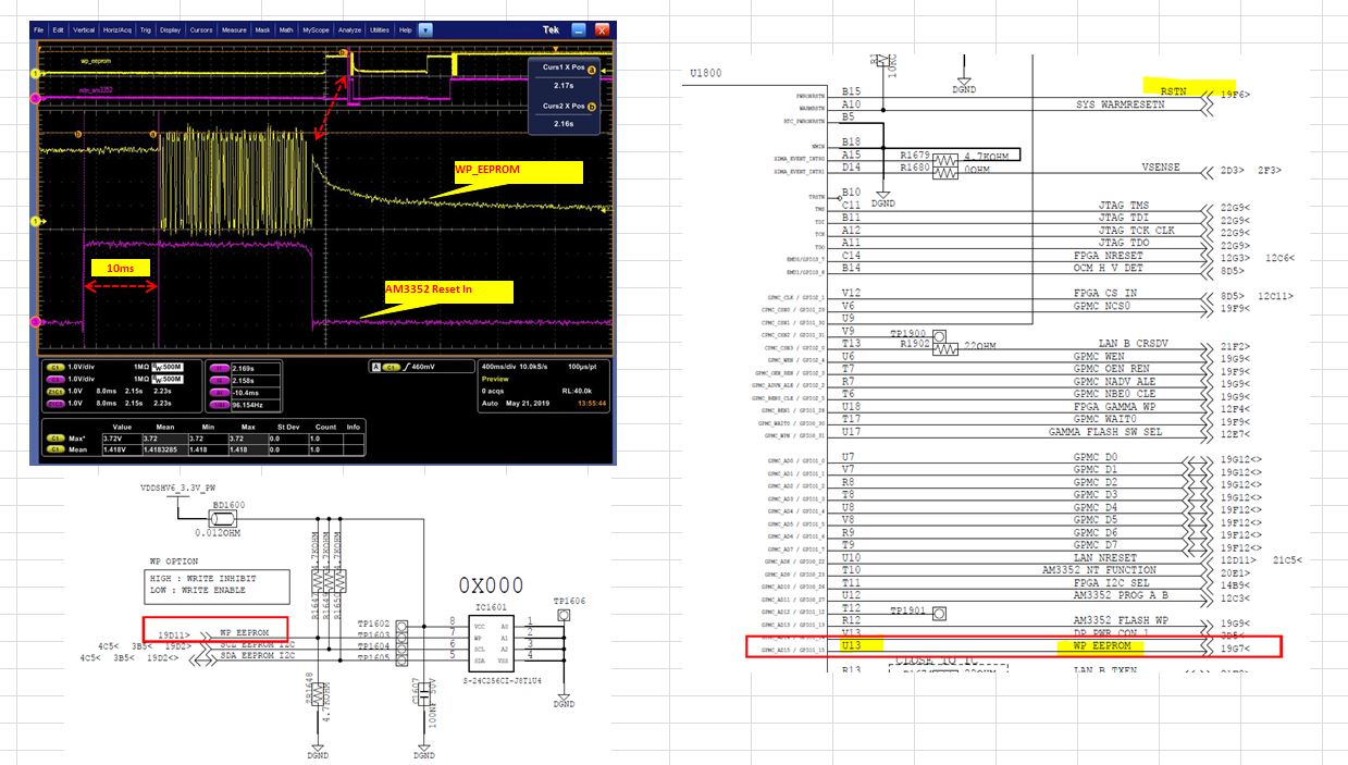

My customer set GPMC-AD15(U13) pin as GPIO and connected it to WP_EEPROM.
They found divergence signal in U13 pin after 10ms of reset as below, and requested how it can be removed.
They confirmed U13 pin was set as GPIO in the mux.c file of SPL, and they are suspecting it is GPMC addressing in RBL although their bootmode is SPI0 bootmode.
Could you please let me know if GPMC addressing was occurred in RBL even when SPI bootmode was used?

    This is the ROM code trying to access GPMC. Please post the exact SYSBOOT values so that we can narrow down the issue further.

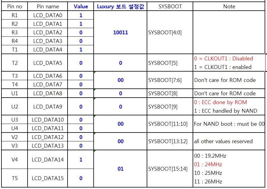

    Their BOOTMODE is as below.
    SYSBOOT[4:0]     : 10011 => NAND/NANDI2C/MMC0/UART0
    SYSBOOT[5]        : 0         => 0 = CLKOUT1 disabled
    SYSBOOT[7:6]     : 00       => Don't care for ROM code
    SYSBOOT[8]        : 0         => Don't care for ROM code
    SYSBOOT[9]        : 0         => ECC done by ROM
    SYSBOOT[11:10] : 00       => 00(for NAND boot)
    SYSBOOT[13:12] : 00       => all other values reserved
    SYSBOOT[15:14] : 01       => 01b = 24Mhz

  • Section 26.1.8.4.2 of the AM335x TRM Rev. P states:
    "GPMC Initialization
    The GPMC interface is configured as such it can be used for accessing NAND devices. The address bus is released since a NAND device does not use it. The data bus width is initially set to 16 bits; and changed to 8 bits if needed after device parameters determination."
