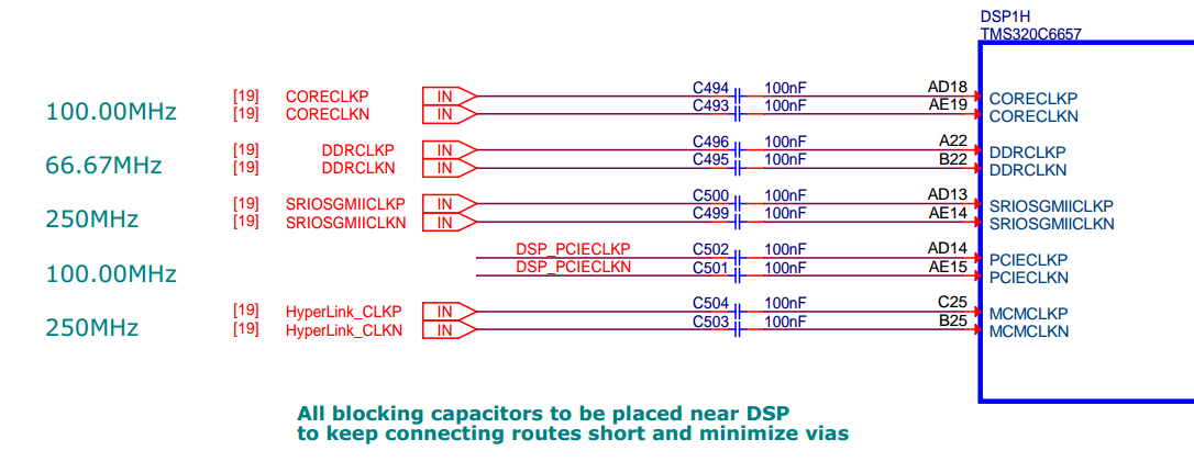

I am using Processor RTOS SDK for C665X. I am building a project for C6654 based on examples from TMDSEVM6657LS.
From the documentation, I copied the /ti/pdk_c665x_2_0_12/packages/ti/board/src/evmC6657 folder and renamed it and now I am editing it.
In the file evmC6657.c in the root folder mentioned above :
/* external input clock to PA/ARM/DDR3 PLLs */
const uint32_t Board_ext_clk[CSL_PLL_MAX] =
    EXT_CLK_100M,    /* sys clock */
    0,               /* no PA clock */
    0,               /* no ARM clock */
    EXT_CLK_50M      /* DDR3 clock */
Shouldn't DDR3 clock be EXT_CLK_66M67 ? I have the EVM and the schematic shows 66.67 feeding the DDR clock pins.
On my custom board the clock input for DDRCLK will be the same as the EVM 66.67MHz.
  1. Is this a mistake ? Should it be as I suggested or I am missing something ?
  2. If yes, what is the purpose of Board_ext_clk, clearly the DDR is working on the EVM
I am using processor_sdk_rtos_c665x_5_02_00_10 on Ubuntu
Update:
Checking the PLL settings in const pllcConfig pllcConfigs[]:
const pllcConfig pllcConfigs[] = {
    {CSL_PLL_SYS,    20,     1,      2}, /* 1000 MHz */
    {CSL_PLL_DDR3,   80,     3,      2}, /* 666.66 MHz*/
It makes sense if DDR3 Clock is 50MHz not 66.67,
50/3 = 16.6666666
16.6666*80 = 1333.33333
1333.3333/2 = 666.66
What am I missing ?
