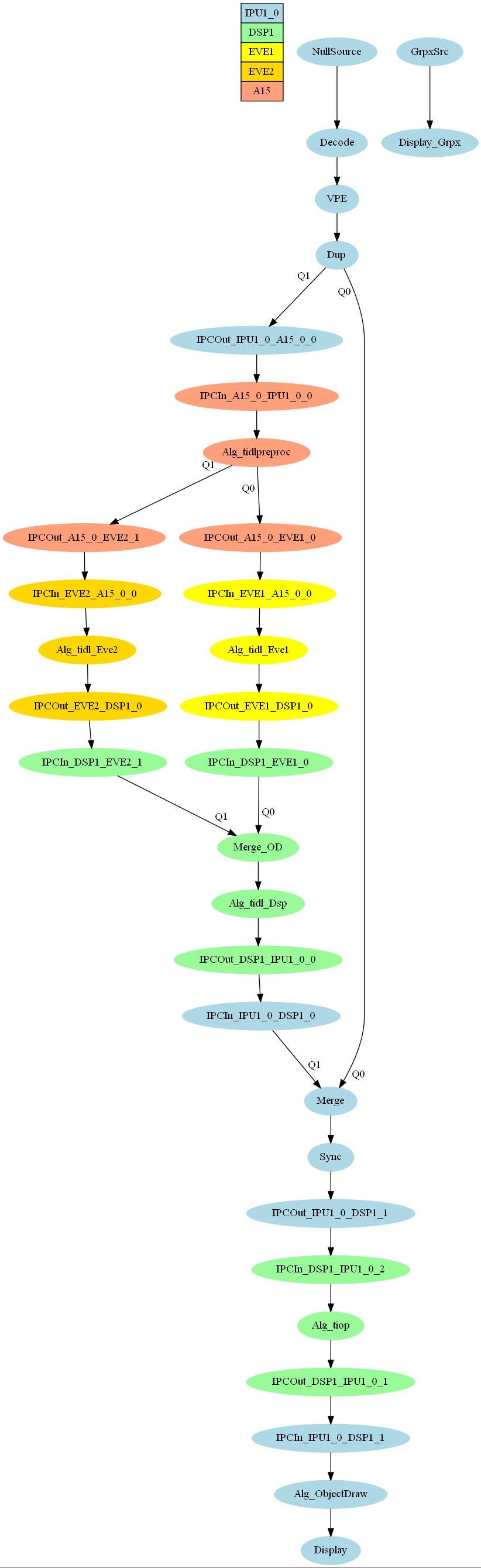

I have hereby attached the performance statistics of the TIDL_OD usecase.From the performance statistics we find that the algorithm links don’t have frame drops. But the VPE link has a frame drop of 10.12 fps.Currently we are getting a frame rate of 17.7 fps after the preprocessing stage of the algorithm. We can observe from the performance statistics of the VPE link that the input fps for the link is 30.59 fps and the output fps from the link is 20.46.There is a frame drop of 10.12 fps.
The VPE link does color conversion from YUV_420 to RGB.It also does scaling. We have to optimize the VPE link and avoid the frame drop. I request you to assist me in optmizing the VPE for avoiding the frame drop.

  • Hello Brijesh,
       The link after VPE is IPC out link from M4.Following that is IPC In link in A15 followed by Alg_TidlPreproc link in A15.The A15 is running at highest frequency of 1500 Mhz.I am not sure why it is not returning buffers in time.Can you please point out why Alg_TidlPreproc is not returning buffers?I will correct the module accordingly.I have hereby attached the chain for your reference.

  • Hi Vijay,
    It may not be IPC link, please check the processing links, running after VPE link and see which link is keeping all the VPE buffer and not returning them in time..

  • Hi Vijay,
    Looking at the log again, it seems your ALG_TIDL takes a lot of time, on the average, it takes around 123ms. Please check if this is ok/correct, if this is the case, you will have to increase number of output buffers..
