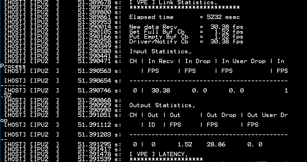

I converted TIDL OD Usecase from RTOS to Linux.
The links of usecase are created normally and started.
However, Only full green screen was showed in display.
When i printed statistics of each link, from NullSrc to Decode link, the 30 FPS was showed both input fps and output fps.
However, from VPE link, Out Drop FPS increased to about 29 FPS like below capture image.
VPE link is executed on IPU1_0.
Could you suggest any solution?

  • Hi Yoo,
    it seems that the VPE link do not receive enough output buffers, can you check if the link after VPE link is holding buffers for longer period of time.

  • Any updates here?
    I checked FPS in a case that has only NullSrc(A15) -> IPCOUT/IN(A15->IPU1_0) -> Decode(IPU1_0) -> VPE(IPU1_0) -> Display(IPU1_0).
    The FPS was showed normally in VPE link.
    However, after i add Dup link, VPE drops almost every frames.
    Then, should i edit Dup link?
    If that, could you suggest any solution?
    Thank you again.
    Yoo.
    I see "Local Link Latency" is quite high for tidl link, but I am not sure if it is higher than expected or normal.
    Let me ping VisionSDK experts to provide more help.
    Yordan
    As Yordan suggested the link latemcy for TIDL link is very high so its keeping the buffer and causes an unavailability of buffer in VPE link which cause a drop.
    Even you are running it in 30FPS which is not possible in any scenario.
    Please check the datasheet of vision sdk.
    If you are running with release profile with all 4 EVE core enabled and running a OPP_HIGH MLO the you can get around 20-22 FPS with TI provided network and params files.
