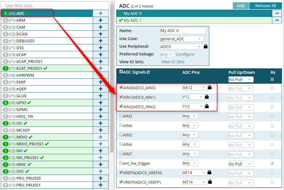

Hello E2E support team,
I have several ADC pins on my board and I need to read the measurements (temperature and voltage). I describe my ADC in the PinMUX, but when I generate am43xx_pinmux_data.c there is NO information about ADC at all. When I look at the provided examples for the IDK_AM437x board:
C:\ti\pdk_am437x_1_0_14\packages\ti\starterware\board\am43xx\am43xx_idkevm_pinmux_data.c
There I can see ADC pins in the provided C code!!!
Here is how I describe my ADC pins:
I tried both ONLINE and OFFLINE tools, but the result is the same - NO pins generated for ADC!
Here is the snippet of the generated code:

No ADC pins listed!
How can I read all my available ADC signals?
How many ADC chips on the board? If I have 7 pins with analog signals should I somehow multiplex these signal to the single ADC chip?
