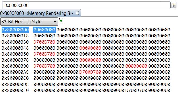

One customer's board. DDR access fail, tried from 400MHz, 300MHz, 303Mhz, to even 200MHz, 100MHz, memory display are 0. already configured timing and control register according to DDR datasheet.
replace different vendor's DDR device, same result, scanned with X-ray, solder is good.
Please give some advices how to debug the "brick"?

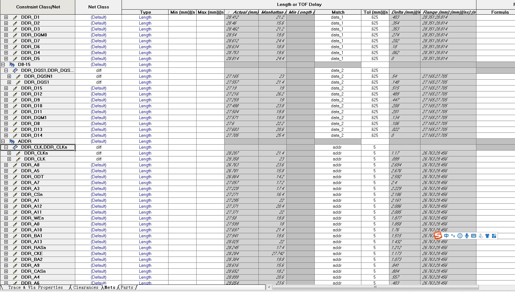

DDR3 layout data as below:
  • Would somebody help me. no matter how to change configuration. can't read/write success.

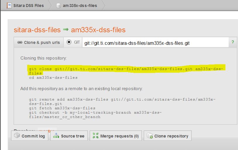

  • Tony, please send the customers Ratio Seed Spreadsheet and the AC Timing spreadsheet from the wiki: processors.wiki.ti.com/.../AM335x_DDR_PHY_register_configuration_for_DDR3_using_Software_Leveling
    Furthermore, have the customer run the ddr-analysis script from this page: git.ti.com/.../master
    Instruction can be found in the README file.
    What is the topology of the DDR3 design? What is the memory part number?

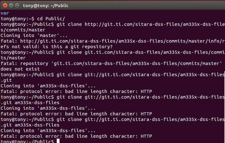

    I can't download the tar ball, either git clone.DDR_configuration.zip
    DDR device: MT41J64M16-125

  • Tony, you should be able to just click on source tree to see the files.  The ddr-analysis.dss is just one file and the README is also there.
    Have your customer change PHY_INVERT_CLKOUT =1 and then make the appropriate changes in the source code

    Now I can and did it. It is a bit confuse to me. it mentioned not to use gel file to initialize target, then the target should be in default status.

    I use gel file initialize board, then disconnect JTAG, use script to dump register configuration. got output as attachment. I tried both 0 and 1  with CMD_PHY_INVERT_CLKOUT. no different to DDR behavior.
    Seems this script was designed to dump register file for checking, I think my configuration should be OK, and I helped many other customer's board DDR bring up before.
    Question:
    #1. If inappropriate DDR layout, will it result in DDR read/write totally fail like a brick?
    #2. From my experience, usually the value write in one address will display on other address. then use DDR leveling can adjust it. but to this board, it did not display on other address.

    customer made 4 pcs boards, same result. I got one on hand for debugging, no matter how to adjust timing, CL, DDR frequency, CPU frequency, no much change on DDR behavior.
  • An offline conference call revealed that the customer has accidentally swapped RAS and CAS signals on the schematic.
    James
