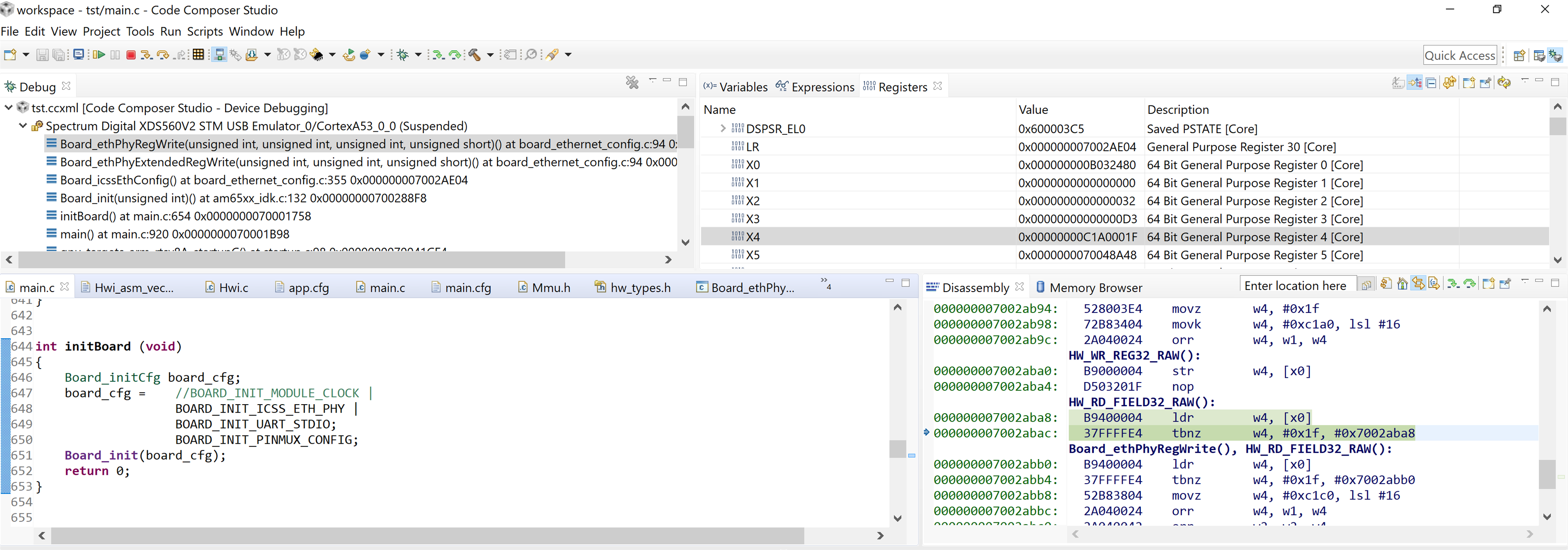

I have issues initialising ETH PHY's (both CPSW and ICSSG) using the Board_Init() Function. At one point the program is waiting for a bit in  PRU_ICSSG0_PR1_MDIO_V1P7_MDIO_ICSSG_USER_ACCESS_REG_j to become zero.
This never happens so the program polls forever in an infinite loop:
CPSW behaves in the same way just with a CPSW specific address.
Any advice on why this might be happening? I am not sure if im missing some configurations steps, so far I have been following the examples provided and Board_Init appears to be the first step of initialisation.
Im using:
AM65x/DRA80xM Industrial Development Kit
CCSv8
XDS560v2 STM USB Emulator
