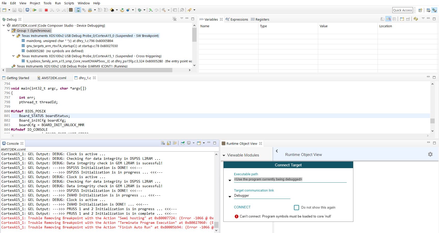

Then we tried to use "Tools->ROV Classic".
But we found "Error" like below on CCS;

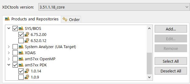

We also checked "RTSC" setting like below;

  • Hi Matusan,
    In the user guide we have: "Open the ROV window (Tools > RTOS Object View (ROV))"
    Can you try with "RTOS Object View (ROV)" instead of "ROV Classic", do you have improvement?

    We didn't find the "dhry_pa15fg.rov.xs" in C:\ti\processor_sdk_rtos_am57xx_5_03_00_07\demos\posix-smp\bin\AM572x\armv7\debug
    So we would like to know how generate "dhry_pa15fg.rov.xs".
    And we tried with "RTOS Object View (ROV)" instead of "ROV Classic" from your comment.
    But we also found error like below;
    Question:
    - Do you see same error ?
    - Could you tell us how to generate "dhry_pa15fg.rov.xs"?
