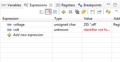

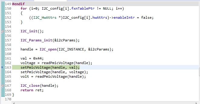

I am trying to rebuild my pmic_test project as per your make file.I successfully build my project and  read voltage using a function readPmicVoltage();.but i could not able to read the voltage using a newly declared variable.
1. first function call that exist in your code
2.after calling the same function and it returned to a newly declared variable named volt.but volt doesn't work properly...
main problem is i could not able to write anything newly to the currently existing code....

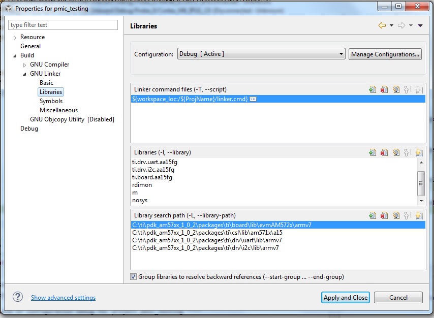

1.Summary of flag set is
-mtune=cortex-a15 -marm -Dam5718 -D__ARMv7 -DSOC_AM571x -Og -g -gdwarf-3 -gstrict-dwarf -w -Wall -specs="nosys.specs" -mfloat-abi=hard -Wl,-Map,"pmic.map" --entry Entry -nostartfiles -static -Wl,--gc-sections -L"C:/ti/pdk_am57xx_1_0_2/packages/ti/osal/lib/nonos/am571x/armv7" -L"C:/ti/pdk_am57xx_1_0_2/packages/ti/csl/lib/am571x/a15" -Wl,--defsym,STACKSIZE=0x10000 -Wl,--defsym,HEAPSIZE=0x800 -Wl,--undefined,__aeabi_uidiv -Wl,--undefined,__aeabi_idiv
2.included libraries
How we resolve this problem?? my ccs version is 8.2 and rtos v 5.01

    The issue could be caused due to compiler optimization options or due to CCS IDE not recognizing the data type for variable. can you add the data type in front of the variable in the expressions view. Does the variable not show in the CCS Variables window (curious why you are looking at the variable from the expressions view). Also, please check if the same issue occurs when you load the binary built using the makefile.
    I am guessing that you are using the pmic_test code that is provided here:
    pdk_am57xx_1_0_12\packages\ti\board\diag\pmic\src  (Can you please confirm)
    Looking at the original code, the test code looks different and the test case use UART_printf to print the values read from the PMIC, have you tried that approach ? We expect the following libraries to be linked from your project so I believe that there could be issues with the way you have translated the makefile to a CCS project.
    BOARD_LIB = "$(PDK_INSTALL_PATH)/ti/board/lib/$(BOARD)/a15/release/ti.board.aa15fg"
    OSAL_LIB = "$(PDK_INSTALL_PATH)/ti/osal/lib/nonos/am571x/a15/release/ti.osal.aa15fg"
    CSL_INIT_LIB = "$(PDK_INSTALL_PATH)/ti/csl/lib/am571x/a15/release/ti.csl.init.aa15fg"
    UART_LIB = "$(PDK_INSTALL_PATH)/ti/drv/uart/lib/am571x/a15/release/ti.drv.uart.aa15fg"
    I2C_LIB = "$(PDK_INSTALL_PATH)/ti/drv/i2c/lib/am571x/a15/release/ti.drv.i2c.aa15fg"
    CSL_LIB = "$(PDK_INSTALL_PATH)/ti/csl/lib/am571x/a15/release/ti.csl.aa15fg"

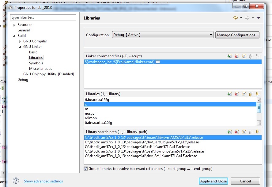

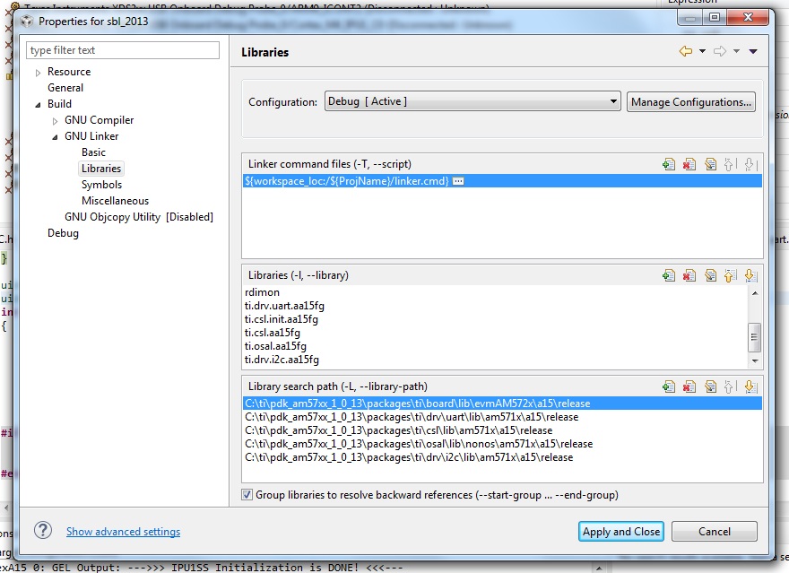

    HI,
    Sorry my SDK RTOS version was 2.02.Now i switched to latest version that you mentioned earlier.but the same issue repeated again.
    UART driver is not working (that's hanged during execution) after including uart library to my project. That's why i removed it...but the problem is now solved  by changing local variable declaration to global variable declaration.but i couldnot able to move with global variable. I think this issue related to ccs.
