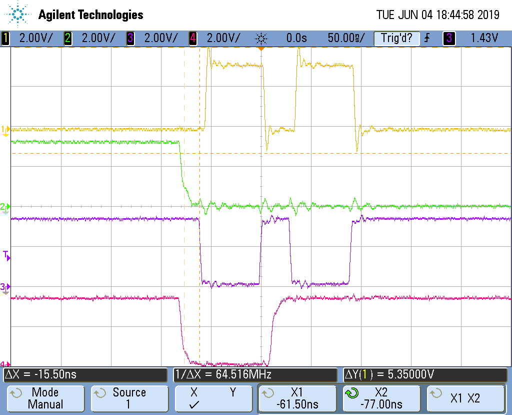

    Here is a capture where we are running CS entirely too quickly (50ns) and ignoring HRDY.
    1, yellow = HRDY
    2, green = HRW
    3, purple = CS
    4, pink = HWIL
    This is a write to HPIA.  I'm writing 0x00004300 into hpia  using the timing below and it is showing in the debugger as 0x43000000.  I'm assuming that flipping the HWOB bit in HPIC will correct this once we have the interface running correctly.
