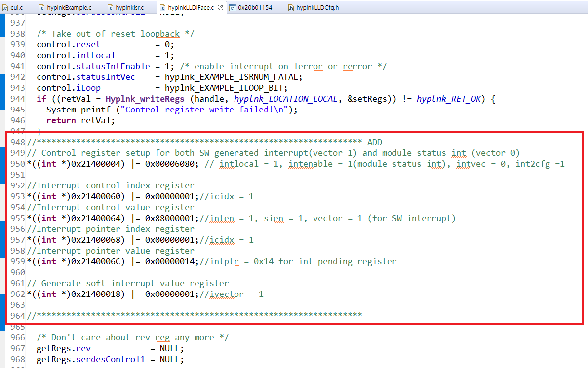

    It doesn't work to see the code you answered and modify parts of the example project code to test.
    In the example project provided, the modifications are as follows:
    1.hyplnkLLDCfg.h
    2.hyplnkisr.c
    3.hyplnkLLDIFace.c
    I referred to "1462.Hyperlink_EVM_example_LE.zip" code.
    HyperLink Register status as see below (CORE0 execute)
    Q1 ) Is there any modify wrong, or is there anything else that needs to be done?
        This code is not execute ISR ...    I don't understand information 64 ??
    >>>  I modified the HostInterrupt and EventId values in the above modification codes as follows for test. ( same supported example source )
            CSL_CPINTC_mapSystemIntrToChannel (hnd, CSL_INTC0_VUSR_INT_O, 32);
            CSL_CPINTC_enableHostInterrupt (hnd, 32);
            hyplnkExampleIntcHnd = CSL_intcOpen (&hyplnkExampleIntcObj, 21, &vectId, NULL);
            eventId = 21;
            hyplnkExampleEvtHdlrRecord[0].arg     = (void *)eventId;
    In the modified code, ISR was executed once.
    However, ISR did not run in the transfer process that was run in the example project. ( at hyplnkExampleIOCycle(); )
    If I write 0x00000002 randomly on the Interrupt Pending/Set Register through the memory browser, ISR is executed.
    Control register 0x6202, 0x6282, 0x2202, 0x2282, 0x6082, 0x2082    ...   for intlocal and int2cfg setting test same.
    Q2 ) Is there any modify wrong, or is there anything else that needs to be done?
            When does the interrupt packet go? ( A hyperlink transmission does not activate the receive interrupt. )

    I need to create a CCS project and code for testing Hyperlink interrupt in loopback mode. We don't have production code and the E2E code is for reference only not maintained. This may take some time.
    Regards, Eric

  • Hi.
    The part I asked for confirmed the drive using the reference code.
    I wanted to check if it was the right move, but after analyzing it, it was confirmed.
    Thank you.

    You should be able to run it with C6678 EVM in no-boot mode and use GEL to initialize the SOC first. The loopback is controlled by "iLoopModeOn". CCS console output:
    [C66xx_0]
    Beginning Hyperlink SW generated Interrupt test
    Interrupt issued !
    Ending Hyperlink SW generated Interrupt test
    Regards, Erichttps://e2e.ti.com/cfs-file/__key/communityserver-discussions-components-files/791/Hyperlink_5F00_EVM_5F00_example_5F00_LE_5F00_C6678.7z
  • Hi.
    It took some time to get around the activation of the interrupt, but it was resolved by referring to the data provided.
