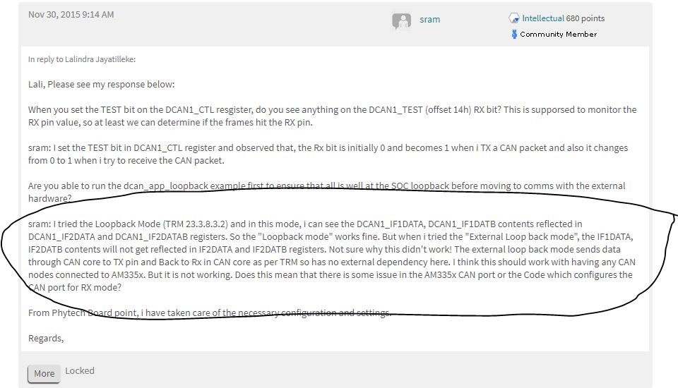

While operating DCAN in test mode internal Loopback test is working fine but External loopback does not.
Even probed Tx pin on Oscilloscope in both cases, where I was able to see data transmission in case of internal loopback but nothing in case of external loopback.
I've found below mentioned archived thread where this issue was queried exactly but no solution was given,
please find attached screen for the same
https://e2e.ti.com/support/legacy_forums/embedded/starterware/f/790/p/470311/1839475
As I'm able to configure and use DCAN for internal Loopback test, please let me know if I need to configure it any
differently for External loopback test apart from changing TEST register bit, TRM section 23.4.6.
