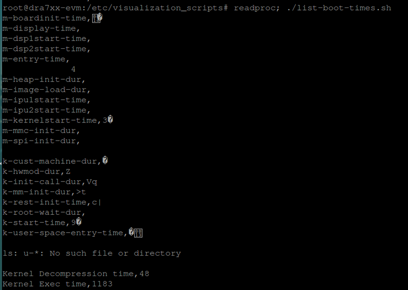

  • Hi Yordan,
    Thanks for the guidance, I was able to disable prints by the services.
    The thing I am facing is that, am not able to run ./list-boot-times.sh.  The following is displayed,
    ls: m-*: No such file or directory
    ls: k-*: No such file or directory
    ls: u-*: No such file or directory
    cat: can't open '/tmp/m-kernelstart-time': No such file or directory
    cat: can't open '/tmp/k-start-time': No such file or directory
    Kernel Decompression time,0
    cat: can't open '/tmp/k-user-space-entry-time': No such file or directory
    Kernel Exec time,0
    What am I missing here ? I have followed the patches. I am not able measure the performance parameters.
    On applying the patches, I found that the eth0 is not able not showing IP address. Is there anything preventing it.
    The readproc utility described in section 5.1 reads the measurements from the chosen node of the device tree and dumps them into /tmp. Please check the files under "/proc/device-tree/chosen".
    if the ethernet module is converted into a module, eth0 may not show an IP address. Please check the kernel configuration.

  • Hi Venkat,
    Under /proc/device-tree/chosen, I am able to see the timing parameters.
    I changed the directory to /proc/device-tree/chosen and was able to see the following:
    Are there any ways to optimize after the kernel execution ?
    Padmesh
    Can you confirm that you are using single stage boot mode and the device tree has the required entries as shown in

  • Thanks Venkat,
    I was able to solve the issue, currently I'm looking into further optimizations in user space.
    Padmesh
  • Hi Padmesh,
    Glad to know it worked out.
    Could you indicate where the application note was unclear or lacking in content ? It will help me in improving it for other users.
    thanks and regards,
    Venkat
  • Hi Venkat,
    I used the fdtput command with bootargs on the required dtb and placed it in qspi flash as well in the emmc.
    Also I cleaned up the filesystem and added it again.
