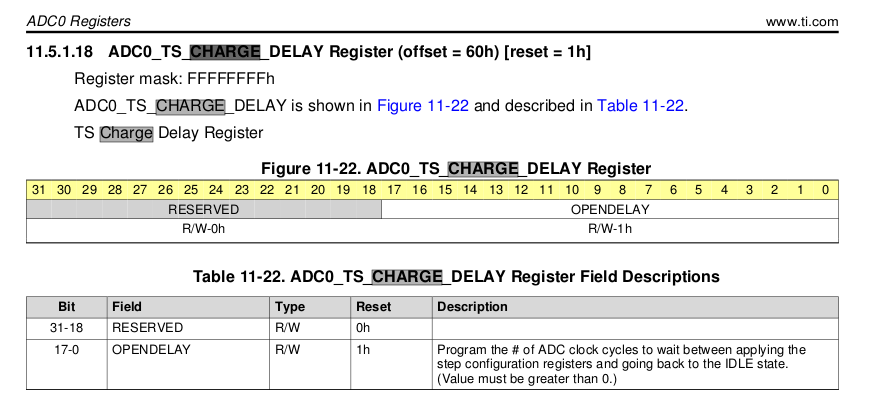

  • Yes, I saw that documentation (it was linked in my original post). But how high can the charge delay go? As you can see, I already have it set at 0x4000. I actually tried going all the way up to 0x9000, but even then I still was not getting 100% accuracy.
  • Tanner,
    I'm sorry I missed the link in your original post.
    I took a look at the driver, and it is using this value to program the TS_CHARGE_DELAY register at line 183 of drivers/input/touchscreen/ti_am335x_tsc.c. Here is an overview of the register:
    So it seems you could theoretically go up to 0x40000.
    I hope this helps.
  • Ron,
    Thank you for pointing me to that register field. The driver documentation says to start with a charge delay at 0x400 but it doesn't say anything about the max value, so I wasn't sure at what point increasing it would stop having an effect. It seems like a charge delay value around 0x20000 gives consistent results for my touchscreen.
