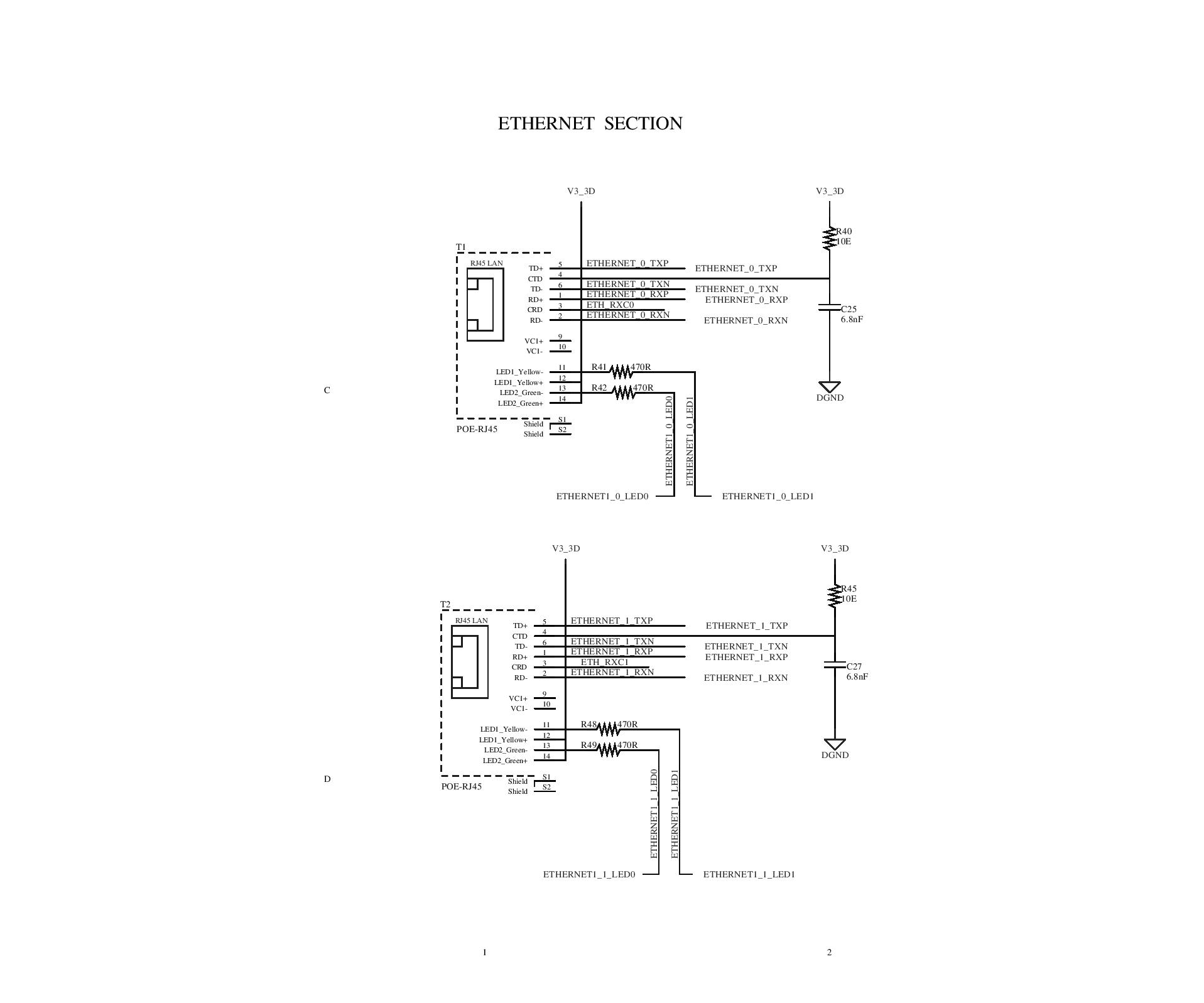

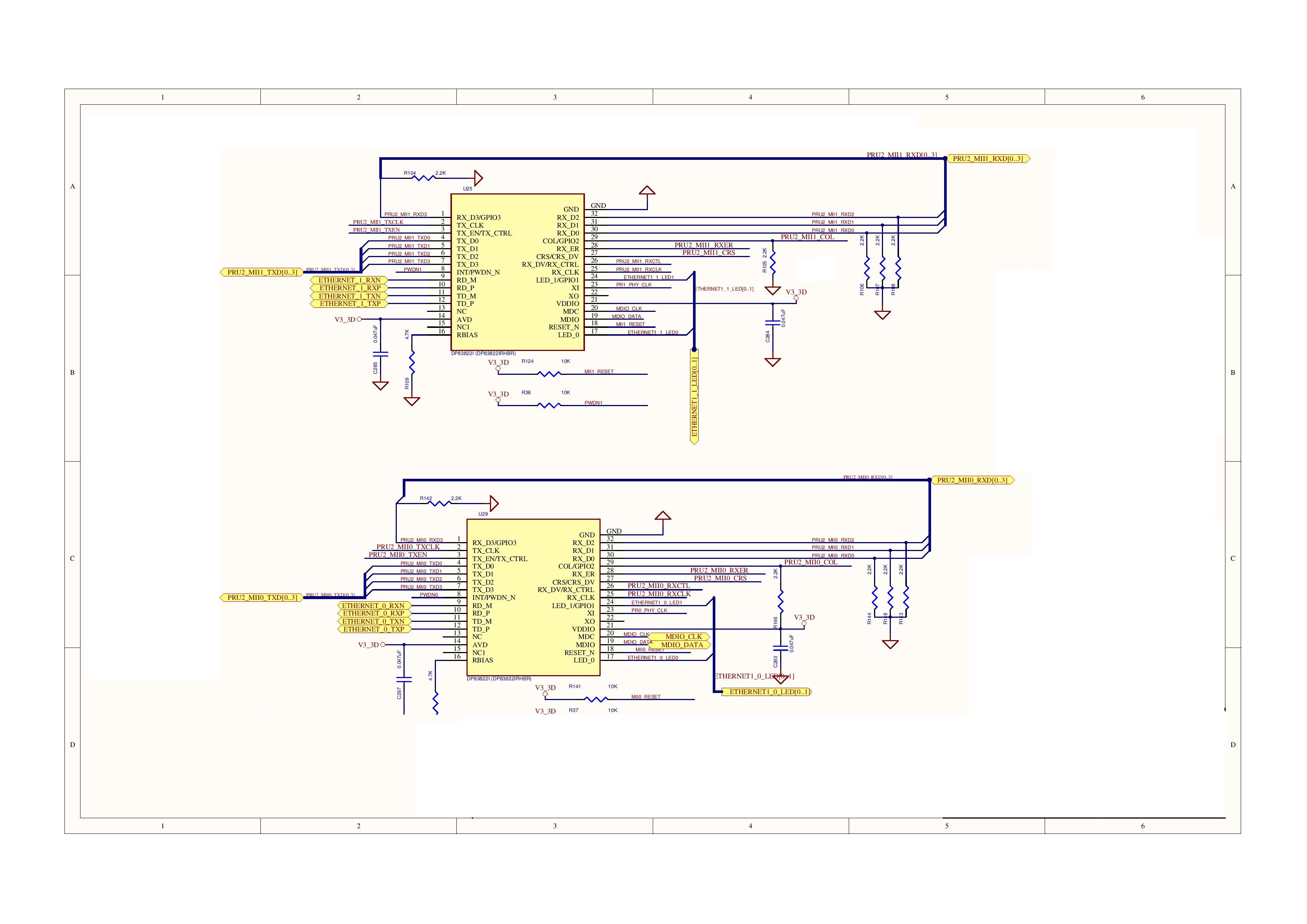

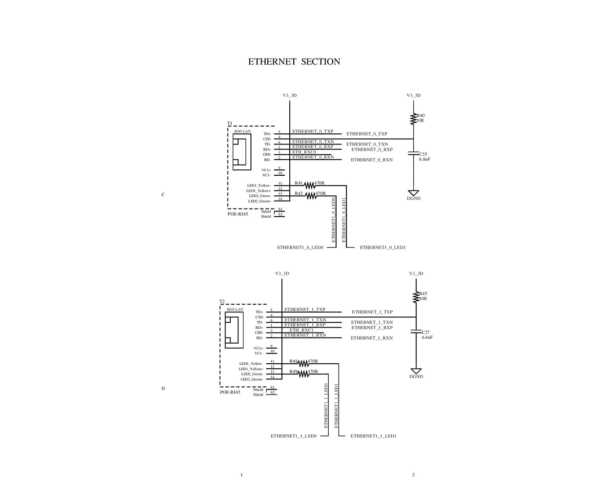

We have used the AM5718 processor for our project & faced the PRU not working issue during the kernel booting up. Here have attached the kernel booting log file for your reference. Could you check & help us to resolve this issue.
Platform Details:
Processor:
AM5718
Ethernet IC: DP83822I
DDR3: 512MB
LogFile:

  • Hi Nick,
    Now we got eth0 and eth1 PRU device, we checked through "ifconfig".
    But we can able to communicate through PHY,I attached my schematic for your reference.
    Regrads,
    suresh
    am57xx-idk-common.tar
  • Hi Nick,
    Regrads,
    suresh
    4812.am57xx-idk-common.tar

    #2 While connect & disconnect the Ethernet cable with the AM5718 platform then we didn't get any "LinkUp" or "LinkDown" messages.(Please note same software working fine in AM5718IDK)
    #3 we have cross checked our schematic with AM571x IDK schematic then we found the "pr2_mii0_rxlink" & "pr2_mii1_rxlink" signals are not connected to PHY(Refer previous replay for schematics).Is this create any issue?
    As per your request, We have attached the console output for your reference.Could you check & feedback us.

  • Hello Suresh,
    I am not sure what the rxlink input does, if anything. I am getting some background information on it.
    Feedback on your devicetree file:
    remember that am571x-idk.dts includes am571x-idk-common.dtsi, which includes am57xx-idk-common.dtsi. So there are additional parts that are needed:
    1) reset gpio for the PHYs (see am571x-idk-common.dtsi)
    2) The proper PRUSS_GPCFG settings (see am571x-idk.dts. Reference section PRU-ICSS I/O Interface in the AM571x technical reference manual, especially Figure 30-2 and tables 30-1 and 30-2). Note that ti,pruss-gp-mux-sel selects the PRUSS_GPCFG settings.
    Nick
