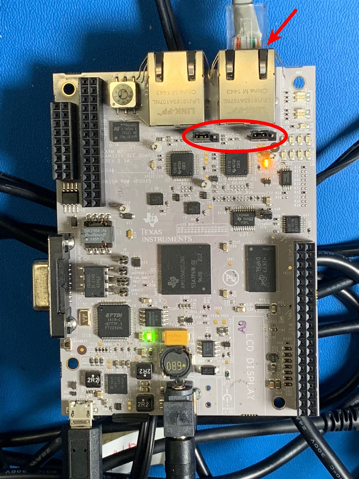

I have a TMDSICE_v2 and I am using it to set up a working baseline for development.
I have gotten so far:
1) I have set up the host Linux development platform based on Ubuntu 18.0.4.
2) I have downloaded and installed the SDK for AM3359 on the host and run the setup.sh script.
3) I have deleted the SPI flash on TMDSICE_v2 and prepared a SD card.
3) I have also got minicom working over USB1.
4) I can boot TMDSICE_v2 using minicom and the SD card, I can log in as root. am3359-evm boots on the target.
5) I now want to boot over TFTP. I have previously installed the TFTP server on my Ubuntu host and tested it with another Windows computer. I can use the get and put commands to transfer files from the Linux host to the Windows computer. I conclude that the TFTP on the Ubuntu host is working properly and it is running.
6) To boot with U-boot over TFTP, I interrupt the target boot process. I enter U-Boot command line with the "=>" prompt. I have not found direct Ti documentation to help me in this part. But using general U-Boot guides, but the procedure here shows what I have done:

    Rather than answer each of your specific questions above at this time, I wanted to get you up and running. Here is a list of commands that I just ran to TFTP Boot an ICE board over CPSW Ethernet. I used the below h/w setup. Please not which connector I'm using and the highlighted jumpers as these are needed to get Ethernet communication going.
    I hope the picture is clear.
    Here is a log of the commands that I ran to get the board booted. Please try this on your set up and let's at least get to the same point. Then, if you have specific questions about how this works, I'll be glad to address them. I've left the responses in so you can compare them to what you are seeing.

  • Hi Ron,
    Thanks for setting up the environment and trying to boot TMDSICE_v2 over TFTP.
    I have set up the hardware as you have indicated with both the ethernet connection and the jumper settings.
    I am using a network with a router where my server ( host Ubuntu ) is receives IP address 192.168.2.60 from the router on the network, and if TMDSICE_v2 boots from SD card, it receives the IP address 192.168.2.63. I have not set up static IP addresses for either, but the router does this every time. If necessary, I could make both static ips, but I don't think it will make any difference.

  • Hi Ron,
    The process worked. I forced the client IP address through static IP to 192.168.2.64 and inserted a tftp command after executing dhcp. I could download the image and start the boot process. It is now booting from tftp.
    I will close the case. I left this note to make let other readers know that the issues were resolved.
