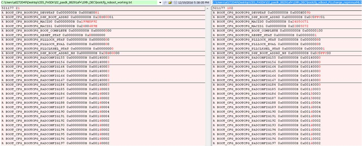

  • Rahul,
    thank you very much for pointing me to the table. Is it available in machine-readable form like an Excel, csv, or similar file? As the code generated by TI Pinmux Tool has different form from the PDK source code, I would like to have an easy way to compare both. Thank you.
    Adam
  • Adam,
    We don`t provide this information in .csv, excel or similar format as part of the TI pinmux tools.  The easiest way to compare the settings would be take register dump of PADCONFIG registers using PDK code and with TI Pinmux settings and doing a diff. We have done this previous during debugging which I have provided for your reference.
    Can you please let us know if method will work for you.
