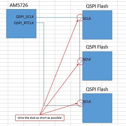

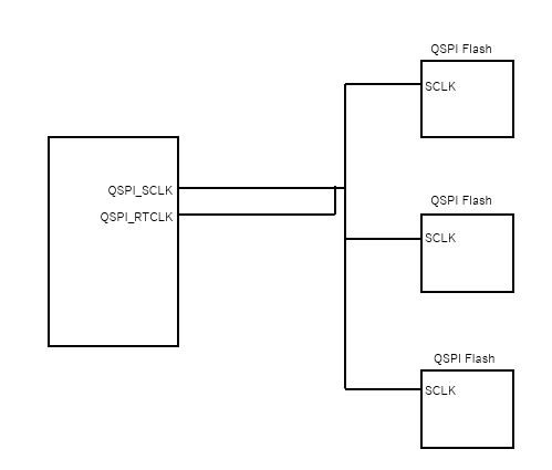

Our customer will use three QSPI flash.
Which is the correct schematic of connecting QSPI_SCLK and QSPI_RTCLK?
There was one connection, but there was no connection for multiple use in the AM572x datasheet.
Figure 8-30. QSPI Interface High Level Schematic
The following is described in TRM. When using in MODE 3, is QSPI_RTCLK loopback not required?
Table 24-355. QSPI I/O Signals
In case Mode 3 is used, there is no need to connect the qspi1_sclk to the qspi1_rtclk.
case1:
case2:
