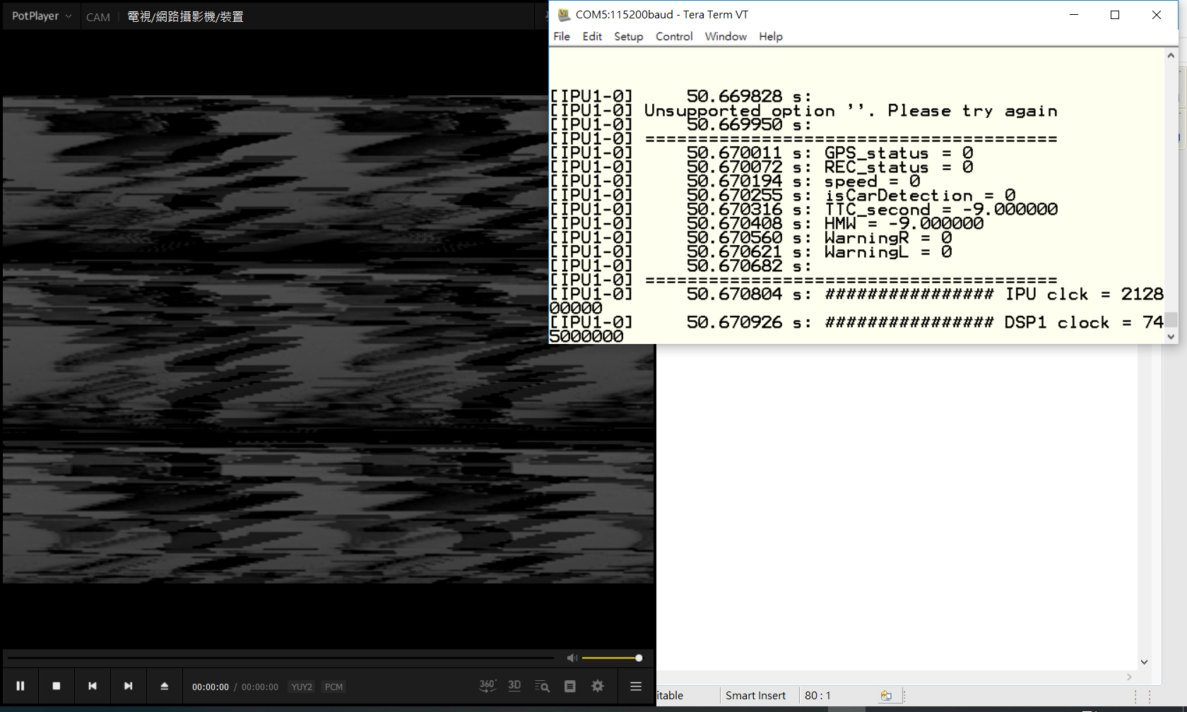

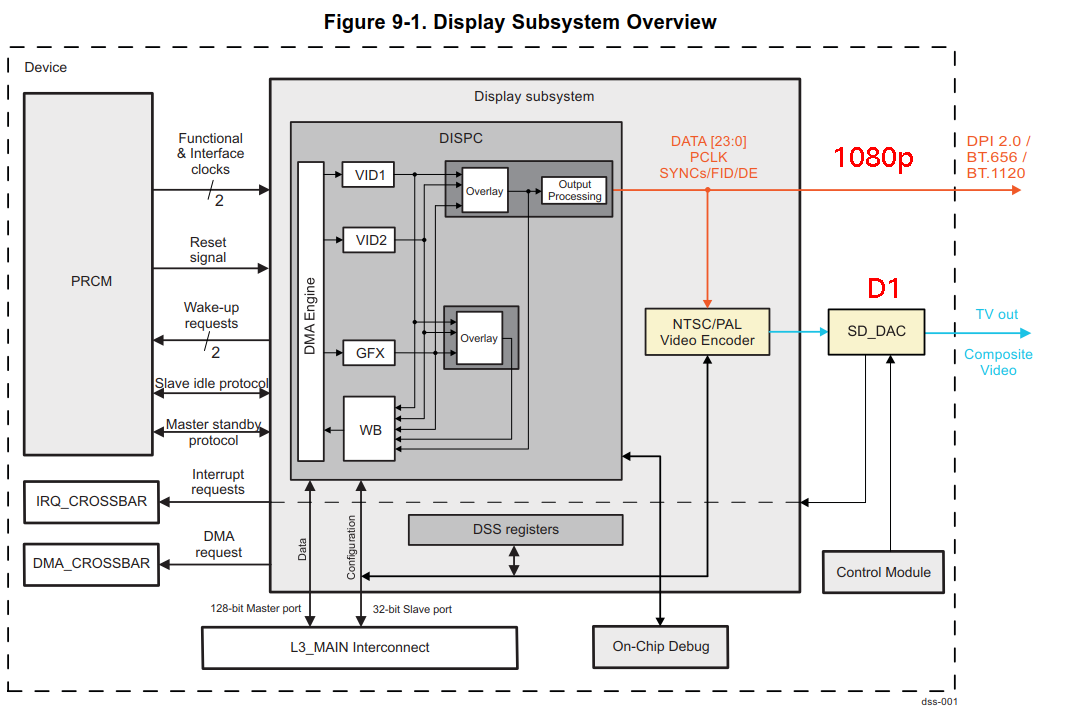

hi,
My SDK : PROCESSOR_SDK_VISION_03_04_00_00
I burn Qspi SBL OPP HIGH
An error occurred while running the app
OPP_OD and OPP_NOM are all running normally

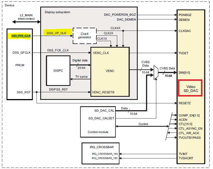

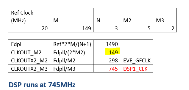

I guess it is ERROR because VID_PIX_CLK changed.

[DSP1  ]      0.312541 s: ################ DSP1 clock = 730000000

[IPU1-0]      1.469133 s:
[IPU1-0]      1.469438 s:  i2cMdSubmitChan: i2c0 transfer to slave address 0x59 failed
[IPU1-0]      1.469529 s: src/bsp_deviceI2c.c @ Line 346:
[IPU1-0]      1.469621 s:  I2C0: DEV 0x59: RD 0x4f ... ERROR !!!
[IPU1-0]      1.469712 s: src/bsp_deviceI2c.c @ Line 412:
[IPU1-0]      1.469773 s:  I2C0: Error timeout 0 ms!!!
[IPU1-0]      1.472518 s:  QSPI Init Started
[IPU1-0]      1.472671 s:  MID - 9d
[IPU1-0]      1.472732 s:  DID - 18
[IPU1-0]      1.472762 s:  QSPI Init Completed Sucessfully
[IPU1-0]      1.480265 s:  UTILS: DMM: API NOT supported in TDA3xx !!!
[IPU1-0]      1.480357 s:  UTILS: DMM: API NOT supported in TDA3xx !!!
[IPU1-0]      1.481211 s:
[IPU1-0]      1.481272 s:  Current System Settings,
[IPU1-0]      1.481302 s:  ========================
[IPU1-0]      1.481363 s:  Display Type   : HDMI 1920x1080 @ 60fps
[IPU1-0]      1.481424 s:  Capture Source : Sensor OV10635 1280x720  @ 30fps - VIP, YUV422
[IPU1-0]      1.481516 s:  My IP address  : none
[IPU1-0]      1.481547 s:  ISS Settings   : LDC=[OFF] VTNF=[OFF] WDR=[OFF]

    Can I change the VID_PIX_CLK  in the file path "PROCESSOR_SDK_VISION_03_04_00_00\ti_components\drivers\pdk_01_10_00_08\packages\ti\boot\sbl_auto\sbl_lib\src\tda3xx\sbl_lib_tda3xx_platform.c",
    change the dpllEveVidDsp15X15CfgOppHigh_20 M、N、Divider M2 ??
    static pmhalPrcmDpllConfig_t      dpllEveVidDsp15X15CfgOppHigh_20 =
        149,                                   /* Multiplier */
        3,                                     /* Divider */
        0,                                     /* DutyCycleCorrector */
        dpllEveVidDsp15X15PostDivCfgOppHigh_20,
        (sizeof (dpllEveVidDsp15X15PostDivCfgOppHigh_20) /
         sizeof (pmhalPrcmPllPostDivValue_t)),
        0
    static pmhalPrcmPllPostDivValue_t dpllEveVidDsp15X15PostDivCfgOppHigh_20[] =
        {PMHAL_PRCM_DPLL_POST_DIV_M2, 5},    /* Div_m2_clkcfg  */
        {PMHAL_PRCM_DPLL_POST_DIV_M3, 2}     /* Div_m3_clkcfg  */
    This is a HW limitation.

    Can I change  the Video SD_DAC  to diplay 720*480 30FPS(SD_DAC) In  the opp high??
    Can you tell me  the  HW limitation detail ?

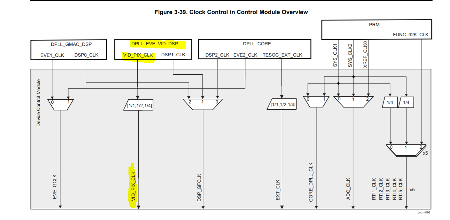

    I have already answered your questions that OPP High cannot be used as the Pixel clock is different.
    You need to understand the clocking structure to see how different PLLs are connected.
    You can refer to Figure 3-39. Clock Control in Control Module Overview in the TRM.
    For more details search EVE_VID_DSP in the TRM.
    Rishabh

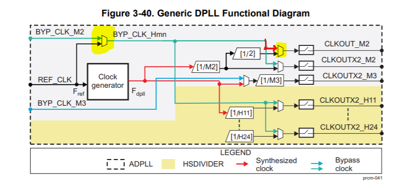

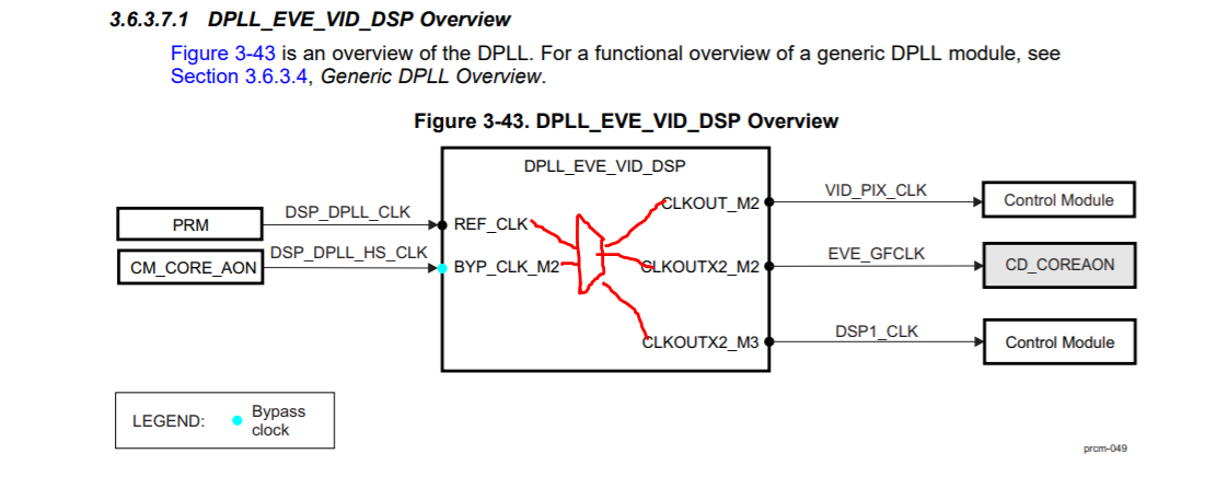

  • HI,
    Follow your prompts  , I have some question and I realy want to know the reason ablout opphigh lock  74.5mhz and 149mhz
    Q1 :The opp high is choose BYP_CLK_Hmn so can not change , is it correct?
    Q2 : The opp normal od high all use  Dpll_EVE_DSP -> ClockOUTM2 -> VID_PIX_CLK for DSS ??
    Below is my trace
    The CLKOUT_M2 choose BYP_CLK_Hmn or Fdpll / M2 / 2
    The DPLL_EVE_VID generate VID_PIX_CLK
    DIVIDER VID_PIX_CLK
    In case of all OPPs, pixel clock comes from DPLL_EVE_VID_DSP.
    DSP and EVE can source clocks from different PLLs as shown in the figure.
    However these DPLLs are used to provide clock to other modules as well.
    Hence there is only one combination where we can get 745 MHz DSP but that puts restriction on DSS Clock.
    If you move to DPLL OD you can use DSP at 709 MHz and there are no restrictions on DSS clock.
    Hope this helps. I am closing this thread.
