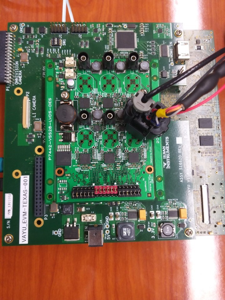

And the below is my board setting. I refered VisionSDK_UserGuide_TDA2xx.pdf Section 2.3.2.
SW3 (VIDEO CONFIG) : 00100101
SW5 : 0001100000
SW2 : 11100000 10000001
Using daughter board and connect camera sensor with Cam1 port.
Should i use OMNIVISION CAMERA port when i want to execute this usecase?
    Yes you should use OMNIVISION CAMERA port only for running single cam usecase.
    And change SW3 (VIDEO CONFIG) : 01010101
    Anuj
    Thank you for your answering.
    BTW, i found the lvds single cam usecase. So, i'm going to test my camera with that usecase.
    Thank you again.
