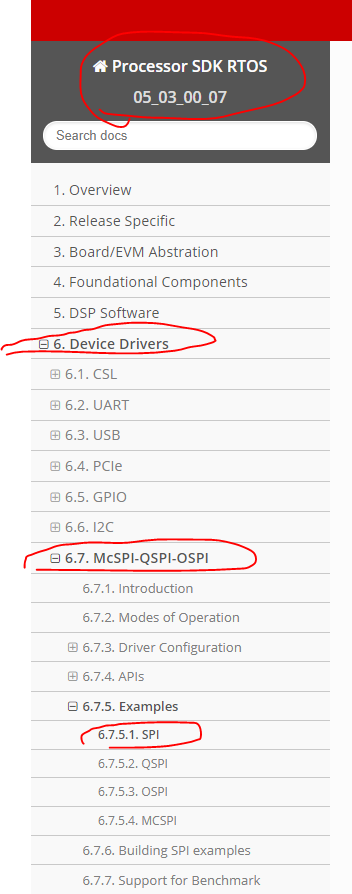

1.My board is IDKAM5728
When I read Device Drivers about SPI
and I find some examples about SPI
->: pdkProjectCreate.bat AM572x idkAM572x little spi all dsp
but I cannot get there examples and I can only get some examples about QSPI and MCSPI
Why? How I can get the examples about SPI?

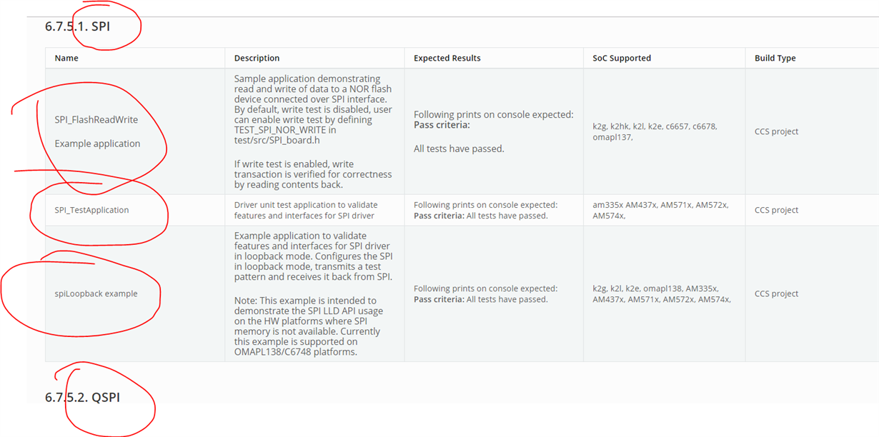

  • Hi user5229477,
    When I run below command, I have "MCSPI_Loopback_idkAM572x_armExampleProject" which should match with "spiLoopback example"
    ~/ti/pdk_am57xx_1_0_14/packages$ ./pdkProjectCreate.sh AM572x idkAM572x little spi all arm
