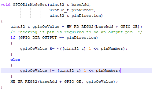

Writing to output enable register(GPIO_OE 0x4805_9134) is generating interrupt. Please explain why it is generating? Writing to GPIO_SETDATAOUT 0x4805_9194) it is working fine.
please explain

Hi Rishabh,
It is not showing anything in registers. It is showing only ???????.
Sagar
Hi Sagar,
What is the CPU you are trying from?
Can you try from DSP or A15?
Rishabh
Hi Rishabh,
I am trying from arm_m-0. In this SoC using arm_m-0, arm_m-1, dsp_0, dsp_1, eve_0 and eve_1;
Thanks!
Hi Sagar,
Has any crashed occurred in the system?
Can you reboot the system and then try without running any binary first.
Rishabh
Hi Rishabh,
No system crash occurred but to do system reset and local reset of DSP1 & DSP2 does it needed to enable the DSP modules?
Because previously it was working correctly without enabling the DSP module but now it is required to enable these modules for the reset.
Sagar
Hi Sagar,
Are you running OnTargetConnect API after running system reset?
You also need to run multicore enable API to enable all slave CPUs.
Rishabh
Hi Rishabh,
I use lauterbach for debugging. From TI we got only starterware package. OnTargetConnect () this API is not available in it. Maybe different platform is there in my office.
Even there is no document for debugging with blackhawk.
Sagar
Hi Sagar,
OnTargetConnect API is available in the gel.
Have you enabled the interrupt for particular interrupt pin?
I can only confirm by looking at register dump.
Maybe you can call register read API and print the value in your application.
Rishabh
