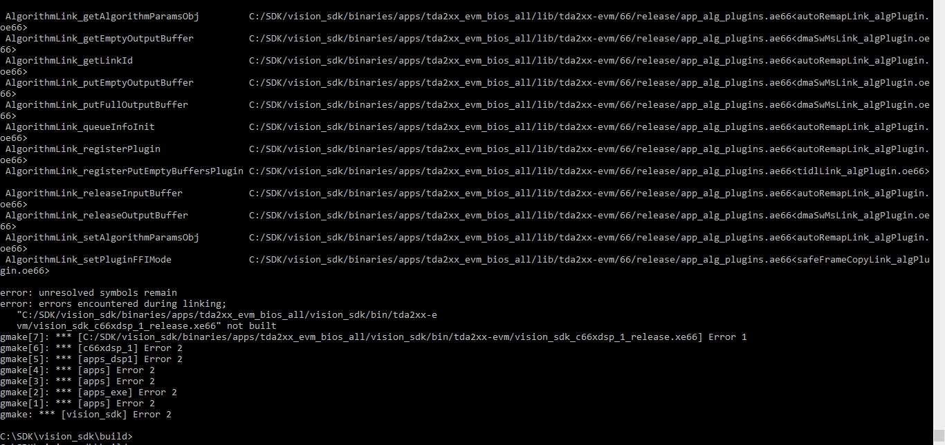

I'm having an issue, while trying to build Processor Sdk Vision 3.6.0.0. I'm following VisionSDK_UserGuide_TDA2xx.pdf for the steps to build in Windows 10. The build process is stuck on the last stage with the error you can find attached below.
Arm gcc is installed, and the first make, done with:
  • gmake -s -j depend
completed successfully. After this step I tried to do :
  • gmake -s -j
and after some time this error occurred:.
  • Hi Alexander,
    Can you try building without "-j" option i.e. "make -s depend" and "make -s".
    Rishabh
  • Hi Rishabh,
    Even with "gmake -s depend" and "gmake -s" the same error happened.
    Aleksander
  • Hi Aleksander,
    Can you run "gmake showconfig" and share the result.
    The issue is with building DSP binary.
    Can you check if C66x compiler is installed and the PATH is correct.
    Can you try re-installation or installation on a different machine.
    Also are you building using Git Bash or command prompt?
    Rishabh
  • Hi Rishabh,
    I uploaded the outputs of the "gmake showconfig" command.
    How do I check if C66x compiler is installed and the PATH is correct?
    Unfortunately, this is the only machine available at the moment.
    I'm building using command prompt.
    Aleksander

  • Hi Aleksander,
    Can you try using git bash? Most likely this will solve the problem if the installation went fine.
    Few customers have faced issues during installation which led to build issue and the issue was resolved on re-installation.
    I would suggest you to try this if the build fails with Git Bash as well.
    Git Bash can be downloaded from the web.
    You need to see tools_path.mk for C6000 compiler path.
    Rishabh
  • Hi Rishabh,
    I tried with git bash and the same problem persists. It gave me the same error.
    My paths are like this:
    CODEGEN_PATH_DSP ?= $(TI_SW_ROOT)/cg_tools/windows/ti-cgt-c6000_8.2.4
    CODEGEN_PATH_EVE ?= $(TI_SW_ROOT)/cg_tools/windows/arp32_1.0.7
    CODEGEN_PATH_A15 ?= $(TI_SW_ROOT)/cg_tools/windows/gcc-arm-none-eabi-4_9-2015q3
    CODEGEN_PATH_M4 ?= $(TI_SW_ROOT)/cg_tools/windows/ti-cgt-arm_16.9.2.LTS
    All of these folders exist in their correct paths.
    Aleksander
  • Hi Aleksander,
    Can you try the re-installation?
    We don't see any issues with build.
    Rishabh
  • Hi Rishabh,
    By re-installation you mean starting from the downloaded file?
  • Hi Alexander,
    Yes. You can start by downloading the file again from ti.com.
    Rishabh
  • Hi Alexander,
    Are you able to build after re-installation?
    Rishabh
  • Hi Rishabh,
    Yes, re-installation solved the problem. Now the build finished without problems.
    Thank you.
    Aleksander
  • Hi Aleksander,
    Glad that your issue is resolved.
    Very few customers have faced build issue due to installation.
    However a large number of customers including TI itself have never faced this issue.
    In case you can provide any insights to what went wrong first time it will be very useful.
    Rishabh
  • Hi Rishabh,
    I think it was the problem of the folder name. During the first installation, to keep the folder's names short I renamed from PROCESSOR_SDK_VISION_03_06_00_00 to SDK. The second time I kept the name as it was suggested and didn't face the error.
    Thank you for your help.
    Aleksander
