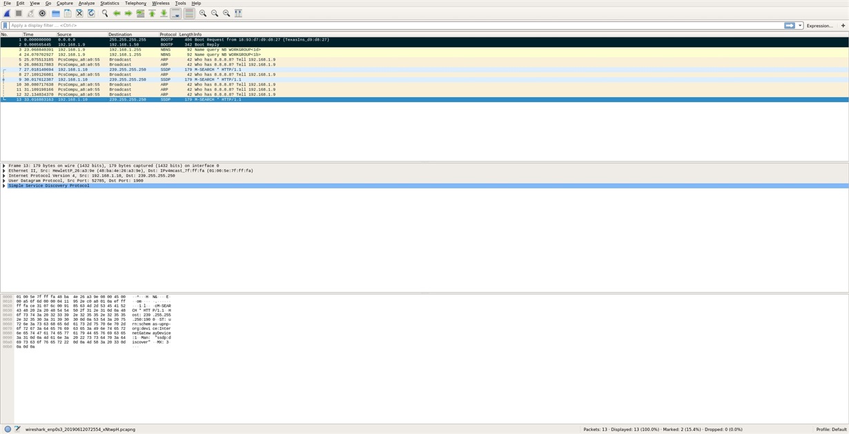

I am using an AM4379 on an AM437x-IDK-EVM to boot over the network interface, ETH0. The configuration pins on the AM4379 have been modified (using the 0ohm resisters on the board.) for the following configuration.
The AM437x-IDK-EVM board is connected to a network interface with bootp server (Ubuntu host) that has dhcpd and tftp sever started. The dhcp conf file is shown below:
When the AM327X-IDK-EVM is powered on it makes a bootp request and the bootp server responds but the AM437x-IDK-EVM does request the u-boot-spl.bin file from the tftp server?
I have the WireShark capture of the two packets highlighted above, but I do not seem be able to attach it to this message?
I have used this Ubuntu server to boot another AM437x-IDK-EVM and it worked as expected, this EVM however appears to be interfacing/booting from the server differently?
Is there a field in the Boot Reply that I may be missing that is not allowing this device to boot? (for example another Next Server type field or a Tftp server field?)

  • Krunal,
    Thanks for your response.  I have reviewed that page previously and have successfully setup my Ubuntu host to boot an AM437x-IDK-EVM configured for Netboot. However; that "working" AM437x-IDK-EVM was replaced with another AM437x-IDK-EVM that is not working.  All the data provided above in this issue is the bootp instance with the second AM437x-IDK-EVM.

  • Hello Rob,
    Could you please share the pcap file of your packet transactions? I am not able to understand packet number 5 because the source name should be "TexasIns_xx" but I do not know who is "PcsCompu_xx". On a test setup, the packet looks like the following:
    "3 0.039959848 TexasIns_xx:yy:zz Broadcast ARP 64 Who has <PC_IP?? Tell <Board_IP>"

  • Rob,
    Thanks. Looking at the PCAP file, the Boot Reply is being sent to a different MAC address than the one that sent the Boot Request. I assume the new board is doing the request and somehow the reply from your PC is being sent to the old board. I don't really understand this, but that is what I see and that would explain why the new board is not trying to proceed as it never sees the reply.
    Have you tried restarting your DHCP/BOOTP server? Should be something like:
    sudo service isc-dhcp-server restart
    I hope this helps.
  • Thanks for the response.
    It did not occur to me to look at that. But you are correct.  Somehow the server had a stick lease with a specific MAC attached to it.
    I had to erase the leases by removing the lease file using the following steps:
    > sudo service isc-dhcp-server stop
    > sudo rm /var/lib/dhcp/dhcpd.leases
    > sudo service isc-dhcp-server start
    Thanks for your help again,
