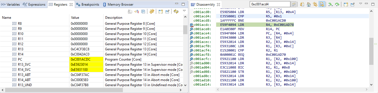

    2. Can you please try stepping into davinci_cpu_suspend with JTAG?  Another option might be to add an assembly spin loop in davinci_cpu_suspend.  Once you get there, I'd like you to look at the Program Counter address to verify you're in internal RAM.
    3. Another test is it put an assembly spin loop after the "Wake up from sleep" comment in davinci_cpu_suspend.
      1. For starters, do NOT connect any JTAG.  I want you to get the OMAP-L138 fully to sleep.
      2. Wake up the device.  It should stick in the assembly spin loop in internal RAM.
      3. Connect with JTAG.  Verify you're in the assembly spin loop in davinci_cpu_suspend.
    I think you can add a spin look by doing something like:
    spin: b spin
    Brad

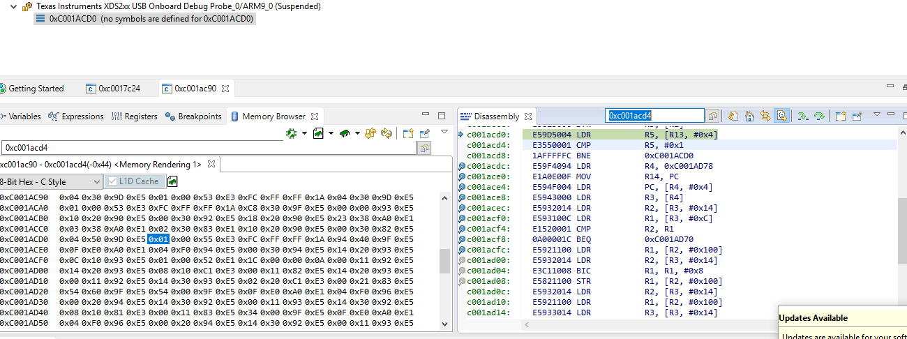

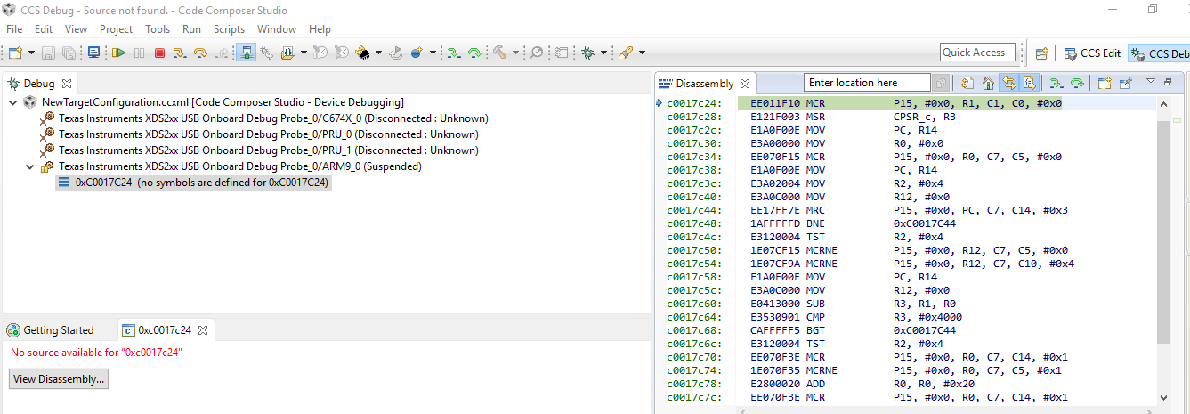

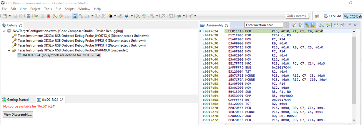

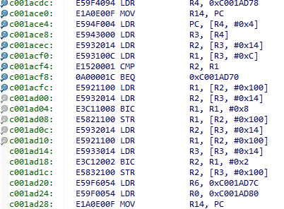

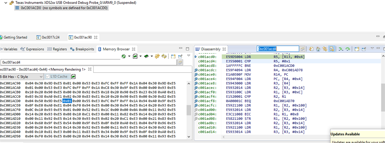

    [Shyam] Added the spinloop entry  just before the section /******** Switch DDR to Self Refresh mode *****/ in the davinci_cpu_suspend  function in sleep. S code.  With JTAG connected upon doing echo mem > /sys/power/state observed that the device entered the deepsleep mode where USB and Ethernet ports stopped working but observed that program counter value is showing up as 0xCXXXXXXX. The PC is not pointing to the internal RAM.

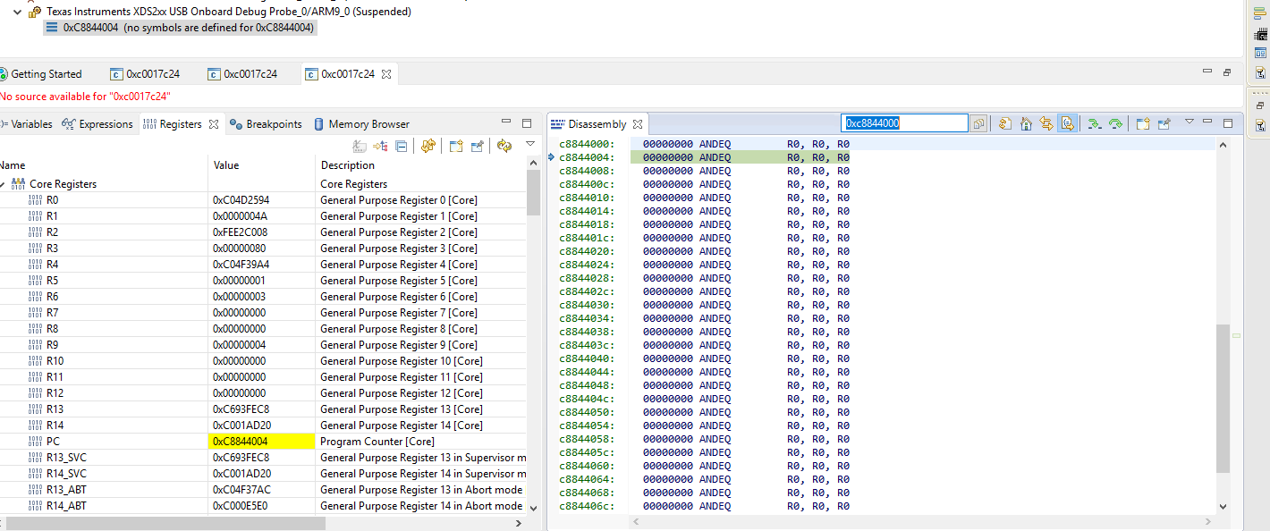

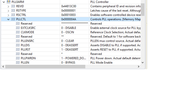

    [Shyam] Observed that device is not waking up from deepsleep mode upon driving the Deepsleep pin high using external signal. With JTAG connected the PC is pointing to address 0xCXXXXXXX
    Note:
    I have added the code code in the sleep.s  for sleepcomplete polling and also have added  spin loop after the "Wake up from sleep" comment in davinci_cpu_suspend. Also added the code for sleepcomplete polling.
    Attached the snapshot caotured incase of point 3. Please share on how to proceed further on this issue

  • When you get to the davinci_pm_suspend() function, go to the disassembly window and use the "assembly step into" button in order to get into the assembly code.
  • Hi Brad,
    Attached the screenshot just post exiting while loop before calling the davinci_sram_suspend(). Have done step into from 0xc001acdc and observed that the PC value is set to 0Xc001acdc and post that i dont see the code executing from SRAM . The address is always pointing to 0xcxxxxxxx.  Please share your comments.
  • Hi Brad,
  • Hi Brad,
  • Hi Brad,
    The below function is supposed to jump the exection to SRAM
    davinci_sram_suspend(pdata);
    On the disassemble of the above function gives the below output
    I dont see any jump instrcution which enable the code to jump to any SRAM address. Please let me know if my understanding is correct.
    Shyam G
  • Hi Brad,
    on doing the step into using the JTAG over CCS the code is executing from 0xc884400 when we jump to code mentioned below.
    In the pm.c file on calling the sram_alloc(davinci_cpu_suspend_sz, NULL); the address  is 0xc8844000.
    Attached the code snippet below for your reference.
    davinci_sram_suspend = sram_alloc(davinci_cpu_suspend_sz, NULL);
    dev_err(&pdev->dev, "SRAM memory Address is %lx", (long unsigned int)davinci_sram_suspend);
    In an ideal case scenario the Sram_alloc() function should have returned address value in the address space (0x80000000 --------------- 0x8001FFFF 128K Shared RAM).
    Instead we have received a address value of 0xC8844000 which falls in the address range ( 0xC0000000 ----------- 0xCFFFFFFF 256M DDR2/mDDR Data).
    This could be reason for the address value showing up 0XCxxxxxx during the JTAG debugging when we call the davinci_sram_suspend(pdata).
    Also observed that in mach-davinci/sram.c file saw the below text before the sram_init().
    It mentions that doesn't yet support the holding code needed for enter and exit suspend states.
    Does this mean the SRAM allocation is not happening from SRAM area and instead it is happening frpm DDR2 area and am assuming this could be the reason for deepsleep not working as expected.
    Please share your comments on this.

    Given the explanation from Sekhar earlier, I suspect this function is actually allocating the code in internal SRAM.  The address we're seeing is a virtual address, but the corresponding physical address likely is in the 0x80000000 vicinity.

    Also observed that the disassembly code starting firm 0xC8844000 is not having any valid assembly code releated to deepsleep enter and exit . Attaching the snapshot captured with JTAG debugging. I am assuming the davinci_sram_push(davinci_sram_suspend,davinci_cpu_suspend, davinci_cpu_suspend_sz) is not copying the code to SRAM .
    Shyam G

    Great idea!  That confirms what I suspected related to difference in virtual/physical addresses.
    Can you confirm at what point you were looking at that memory?  Did you put a spinloop in the davinci_pm_suspend C code and look at the corresponding disassembly at that time? I just want to be sure you weren't connecting at a random time and looking at that area of memory.  Since the page tables change depending on context that mapping wouldn't always be valid.
    Can you look at that same memory through a memory window?  Does it also show as all zeros?
    Another thought might be to put a spin loop before the davinci_sram_push function such that you can look at that address before/after the davinci_sram_push() call.  That would allow you to see whether it was relocating the code as expected in the first place.  Perhaps there is code elsewhere that is zeroing out that SRAM, etc.
  • Update:  I had some offline discussion with Shyam as there was some issue with the forum.
    Looks like immediately following davinci_sram_push() the assembly code is viewed in the expected location.  By the time the sleep code runs, it shows as all zeros.  So it seems like something is Shyam's system is blasting that memory.  Another possibility might be if the MMU mappings changed.  You could check for that possibility by disabling the MMU while halted and then viewing the physical address in the window.
