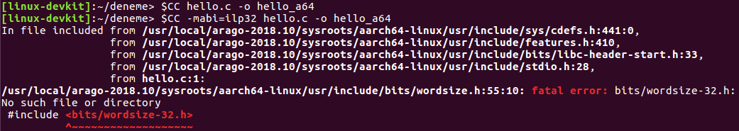

Currently ı am working with Linux-RT processor SDK for AM65x. I installed  linux-devkit.
But When ı compile with -mabi=ilp32 compile option I am getting "No such file or Directory" error for "-32.h" header.
These headers and binaries in missing under arago install path.
How Can ı extend this cross compile environment with necessary header and binaries?
