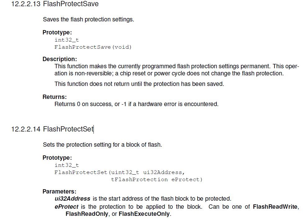

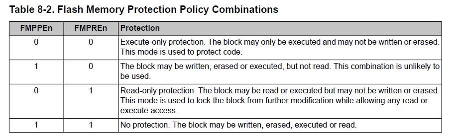

Hello

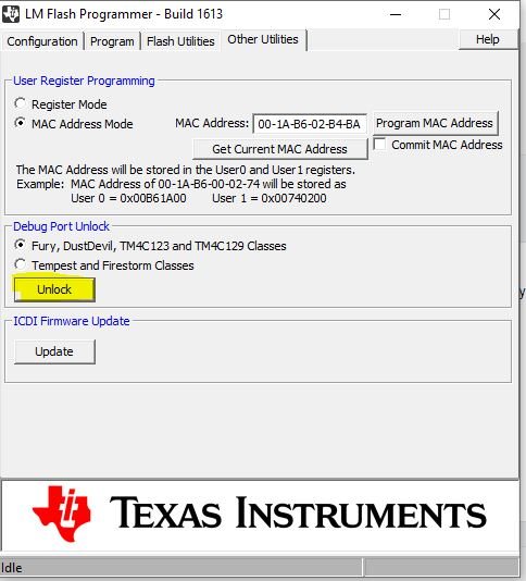

I am not long working with arm and I prepared a bootloader for TM4C1290NCPDT and I would like to protect so there are no way to write by mistake even if I want to change could be nice to only be able to change the bootloader with JTAG. after write that part of code I could not even program again the arm .. even I tried doing the the unlock sequence and did not work again the arm! if somebody can give me a hand I will be really thankfully.
