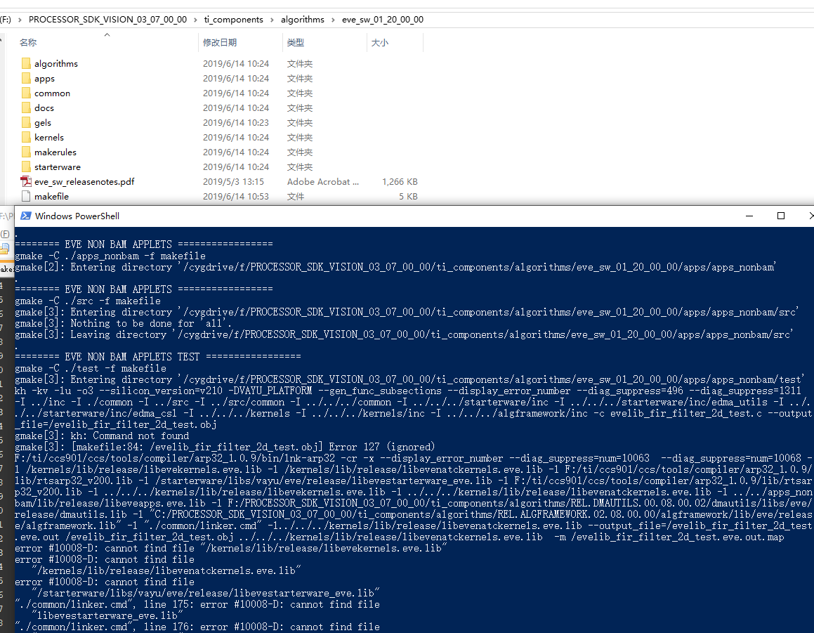

Recently,I have some research base on TDA3 EVM ,so i download the VersionSDK “PROCESSOR_SDK_VISION_03_07_00_00” from yours websites,and Install it in win10 system. But follow your userguide (eve_starterware_userguide)to build EVE Starterware, some error happened,I need your give me some suggestion,THX.

F:\PROCESSOR_SDK_VISION_03_07_00_00\ti_components\algorithms\eve_sw_01_20_00_00>gmake TARGET_SOC=vayu CORE=eve

kh -kv -lu -o3 --silicon_version=v210 -DVAYU_PLATFORM --gen_func_subsections --display_error_number --diag_suppress=496 --diag_suppress=1311 -I ../inc -I ./common -I ../src -I ../src/common -I ../../../common -I ../../../starterware/inc -I ../../../starterware/inc/edma_utils -I ../../../starterware/inc/edma_csl -I ../../../kernels -I ../../../kernels/inc -I ../../../algframework/inc -c evelib_fir_filter_2d_test.c --output_file=/evelib_fir_filter_2d_test.obj
gmake[3]: kh: Command not found
gmake[3]: [makefile:84: /evelib_fir_filter_2d_test.obj] Error 127 (ignored)
F:/ti/ccs901/ccs/tools/compiler/arp32_1.0.9/bin/lnk-arp32 -cr -x --display_error_number --diag_suppress=num=10063 --diag_suppress=num=10068 -l /kernels/lib/release/libevekernels.eve.lib -l /kernels/lib/release/libevenatckernels.eve.lib -l F:/ti/ccs901/ccs/tools/compiler/arp32_1.0.9/lib/rtsarp32_v200.lib -l /starterware/libs/vayu/eve/release/libevestarterware_eve.lib -l F:/ti/ccs901/ccs/tools/compiler/arp32_1.0.9/lib/rtsarp32_v200.lib -l ../../../kernels/lib/release/libevekernels.eve.lib -l ../../../kernels/lib/release/libevenatckernels.eve.lib -l ../../apps_nonbam/lib/release/libeveapps.eve.lib -l F:/PROCESSOR_SDK_VISION_03_07_00_00/ti_components/algorithms/REL.DMAUTILS.00.08.00.02/dmautils/libs/eve/release/dmautils.lib -l "C:/PROCESSOR_SDK_VISION_03_07_00_00/ti_components/algorithms/REL.ALGFRAMEWORK.02.08.00.00/algframework/lib/eve/release/algframework.lib" -l "./common/linker.cmd" -l../../../kernels/lib/release/libevenatckernels.eve.lib --output_file=/evelib_fir_filter_2d_test.eve.out /evelib_fir_filter_2d_test.obj ../../../kernels/lib/release/libevenatckernels.eve.lib -m /evelib_fir_filter_2d_test.eve.out.map
error #10008-D: cannot find file "/kernels/lib/release/libevekernels.eve.lib"
"/kernels/lib/release/libevenatckernels.eve.lib"
"/starterware/libs/vayu/eve/release/libevestarterware_eve.lib"
"./common/linker.cmd", line 175: error #10008-D: cannot find file
"libevestarterware_eve.lib"
"./common/linker.cmd", line 176: error #10008-D: cannot find file
"./common/linker.cmd", line 201: error #10008-D: cannot find file
"./common/linker.cmd", line 202: error #10008-D: cannot find file
"./common/linker.cmd", line 203: error #10008-D: cannot find file
"./common/linker.cmd", line 204: error #10008-D: cannot find file
"./common/linker.cmd", line 228: error #10008-D: cannot find file
error #10008-D: cannot find file "/evelib_fir_filter_2d_test.obj"
warning #10208-D: automatic RTS selection: attempt to automatically link in
index library "libc.a" failed; file not found
fatal error #10009: no input files
gmake[3]: *** [makefile:87: /evelib_fir_filter_2d_test.eve.out] Error 1
gmake[3]: Leaving directory '/cygdrive/f/PROCESSOR_SDK_VISION_03_07_00_00/ti_components/algorithms/eve_sw_01_20_00_00/apps/apps_nonbam/test'
gmake[2]: *** [makefile:11: all] Error 2
gmake[2]: Leaving directory '/cygdrive/f/PROCESSOR_SDK_VISION_03_07_00_00/ti_components/algorithms/eve_sw_01_20_00_00/apps/apps_nonbam'
gmake[1]: *** [makefile:9: all] Error 2
gmake[1]: Leaving directory '/cygdrive/f/PROCESSOR_SDK_VISION_03_07_00_00/ti_components/algorithms/eve_sw_01_20_00_00/apps'
gmake: *** [makefile:65: all] Error 2
