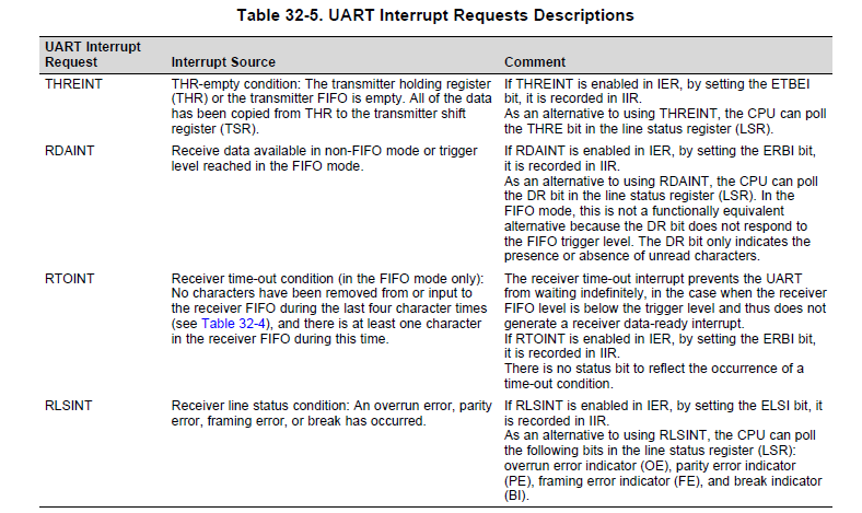

  • Hello prashant,
    Can you check the UART interrupt register after the first value is received and the application has hanged? Specifically, these registers:
    Regarding the test example, the data gets stored in transaction.buf before each transaction:
