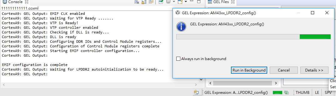

We used LPDDR2 (EDB8132B4PB) for AM4376 and would like to optimize DDR timing by using CCS.
We found the CCS is waiting for LPDDR2 autoinitialization  for a long time and cannot finish successfully
GEL modification

  • The GEL is waiting for a specific value (0x18) from MR0 in the LPDDR2 to indicate that there is no error condition and the initialization is complete.  This byte is read on DQ[7:0].  If the layout of your board is not 1-to-1  (ie, AM437x DQ0 = DDR DQ0, AM437x DQ1 = DDR DQ1), then that value will be different.
    You can include a GEL_TextOut function to see what is being read, and see if that corresponds with the layout of DQ0-7.
    The other possibility is that the DDR is not get initialized properly because of a bad configuration.  Check the point above first, and then we can check configuration issue if that did not solve the problem.
    James

    I found it halted in below code of GEL files
    //at this point, we can check the MR0 register of the LPDDR2 memory to ensure auto-initialization in memory is complete
    //when complete, DAI should be 0x0, RZQI should be 0x3
    //check memory datasheet for definition of these bits
    GEL_TextOut("Waiting for LPDDR2 autoinitialization to be ready...\n");
    GEL_TextOut("\n");
    WR_MEM_32(EMIF_LPDDR2_MODE_REG_CFG,0x00000000);
    while((RD_MEM_32(EMIF_LPDDR2_MODE_REG_DATA) & 0xFF) != 0x18);
    GEL_TextOut("LPDDR2 autoinitialization complete!\n");
    if we ignore below source code and add delay time, it can boot sucessfully
    //while((RD_MEM_32(EMIF_LPDDR2_MODE_REG_DATA) & 0xFF) != 0x18);
    We also implement this method in u-boot and it worked.

  • Yimin, if you change the while loop like this
        GEL_TextOut("MODE_REG_DATA = %x\n",,,,,RD_MEM_32(EMIF_LPDDR2_MODE_REG_DATA) );
    You can see what is being read by the processor.  It is better to use the DAI status bit, otherwise, you cannot be sure the LPDDR2 was initialized properly.
