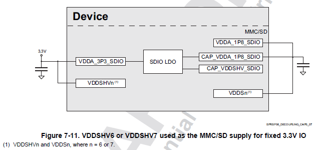

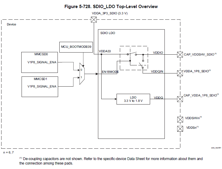

I am using MMC0 to interface with an eMMC @ 3.3V. I am not using MMC1.
I currently have VDDS7 being supplied by CAP_VDDA_1P8_IOLDO0 and VDDS6 being supplied by CAP_VDDA_1P8_SDIO.
(1) Should I be using the SDIO LDO when using eMMC or is it only intended for an SD Card?
(2) Do I configure MCU_BOOTMODE_09 as '0' (MMC0) even though I am operating the I/O @ 3.3V?
(3) If the answer is to not use the SDIO LDO (change VDDS6 to CAP_VDDA_1P8_IOLDO1) - how should MCU_BOOTMODE_09 be configured?
