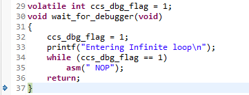

    Then i try to dodge this problem by enable the call to wait_for_debugger() in board_init_f() in the file arch/arm/cpu/armv7/omap-common/hwinit-common.c.
    After that i can debug the code between boart_init_f and spl_relocate_stack_gd.
    In my opinion, the spl code was been relocate after the spl_relocate_stack_gd. That's why i can't continue step over the remain code.
    So, my question is how to debug the code after the relocation operation.i.e. the board_init_r() function call.
    Liu Gan
  • Hi Shravan,
    I solved this problem by enable the call to wait_for_debugger() in spl_board_init() instead of in board_init_r(). Then i load spl/u-boot-spl without the code offset and data offset being set.After that i can debug step by step the code start from spl_board_init().

    I have double checked question 2: What's the difference in calling the wait_for_debugger() from the board_init_r() and spl_board_init()?
    Hear is some details:
    1. My program can be halt at the funtion wait_for_debugger() if i call it from the entry of board_init_r().
    2. I can debug the code if i modify ccs_dbg_flag to 0 in the CCS expressions window. But the CCS has no respone once the infinite loop is exit.It just stoped at the end of the function no matter i try to step in or step over.
