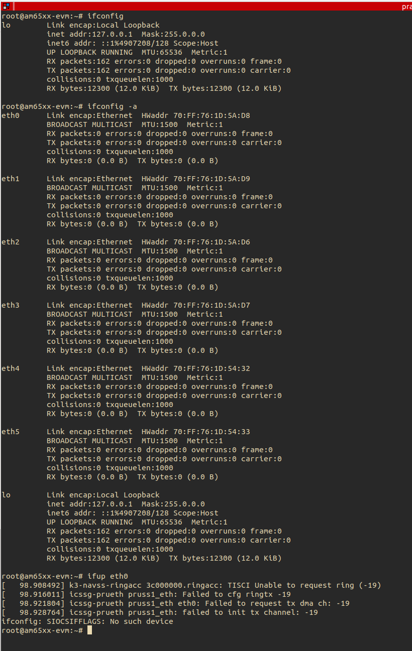

I am facing an issue where the board is resetting after a few minutes and I am also seeing a prompt for Kernel Panic.

How do I go about figuring out what is causing this Kernel Panic? What one of our vendor is mentioning is that it is the Cryptodev module provided with the SDK.
Please advise.
