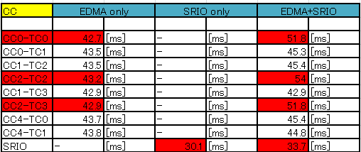

We used to experiments performance test for SRIO communication and EDMA.
EDMA use read / write between DDR3A and C66 L2 cache. .
SRIO write data to DDR3A
<Experiments combination>
①:Measure communication speed with activate EDMA each of channel (CC0-TC0, CC0-TC1, CC1-TC2, CC1-TC3, CC2-TC2, CC2-TC3 )  and disabled SRIO
②:   Measure  communication speed  with activate EDMA(CC0-TC0, CC0-TC1, CC1-TC2, CC1-TC3, CC2-TC2, CC2-TC3)and receiving data on the SRIO
③:Confirmed EDMA speed change with SRIO activate or not.
<Result>
Each of CC0-TC1, CC1-TC2, CC1-TC3 speed decreased 0 -5% due to SRIO module active
Each of  CC0-TC0, CC2-TC2, CC2-TC3 speed decreased 20-25% due to SRIO module active

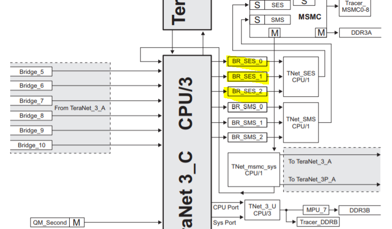

    Sorry for misunderstanding "Bridge_SES"  mean BR_SES_x  indicate as bellow module.
    Actually, customer would like to simply know why SRIO activate affect to "BR_SES_0" communication speed ?
    they would like to know this back ground.

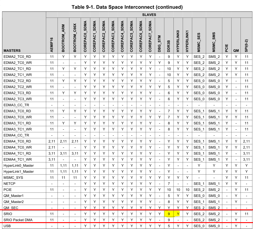

    From the K2H datasheet, Table 9-1, SRIO ---- SES2---- MSMC. From Figure 9-1 and 9-3, TeraNet3_A→Bridge_9→TeraNet3_C→Bridge_SES2→MSMC→DDR3A. I am not sure how do you know it is bridge_9, not bridge_5, 6, 7, 8, 10?
    On the same Table 9-1, only EDMA2 CC0 and CC1 access the DDR3A via SES2. The rest goes either SES0 or SES1. From your test cases, it looks no resource contention in the Teranet level.

    >From the K2H datasheet, Table 9-1, SRIO ---- SES2---- MSMC. From Figure 9-1 and 9-3, >TeraNet3_A→Bridge_9→TeraNet3_C→Bridge_SES2→MSMC→DDR3A. I am not sure how do you know it is bridge_9, not bridge_5, 6, 7, 8, 10?
    - Please see this table 9-1 red circle. We understand bridge_9 at yellow high light.

    We had checked with the design team to understand the connections between different EDMA CC/TC or SRIO into MSMC or GEM. While still try to find the path difference across SES_0 or SES_1, I want to check with you the EDMA and SRIO bus priority you used for the test setup.
    For EDMA CC/TC, the bus priority is set by QUEPRI registers, the reset value is 0 and means the highest priority. There are CSL API to set/get those.
    static inline void CSL_edma3SetEventQueuePriority
        CSL_Edma3Handle hModule,
        Uint8           eventQueue,
        Uint8           priority
    static inline Uint8 CSL_edma3GetEventQueuePriority
        Uint8           eventQueue
    For the SRIO, the bus priority is set by RIO_PER_SET_CNTL for VBUS transaction priority, the reset value is 4 with 0 the highest and 7 the lowest. There is also CSL call to get/set those:
    CSL_SRIO_GetTransactionPriority (CSL_SrioHandle hSrio,Uint8 *priority)
    CSL_SRIO_SetTransactionPriority (CSL_SrioHandle hSrio, Uint8 priority) .
    Can you confirm what was the priority setting you used? Also, if you set SRIO to 7 and set the EDMA to 0, will it help the EDMA passing through the traffic?

    From my review of the internal spec, it appears that the path for SRIO should be as follows
    SRIO→ TeraNet3_L→TeraNet3_A→Bridge_8→TeraNet3_C→Bridge_SES1→TNET_SES→MSMC→DDR3A.
    I need to confirm this from the design team, and see if the datasheet is incorrect, showing Bridge 9 and SES2 instead.
    It almost appears that if the CC/TC combinations that use SES1 (same as SRIO) seem to work better , interleave things better vs CC/TC that use SES0.

  • Hi Omori-san
    From the data  you shared offline, it does appears that putting EDMA at higher priority significantly improves EDMA performance compared to the case when SRIO was running at higher priority.
    From the topology the common point for SRIO and EDMA accessess to/from DDR as the SES bridges to MSMC.
    So there will be some delay incurred and the paths are not completely independent.
    So I think overall the update results look ok?
