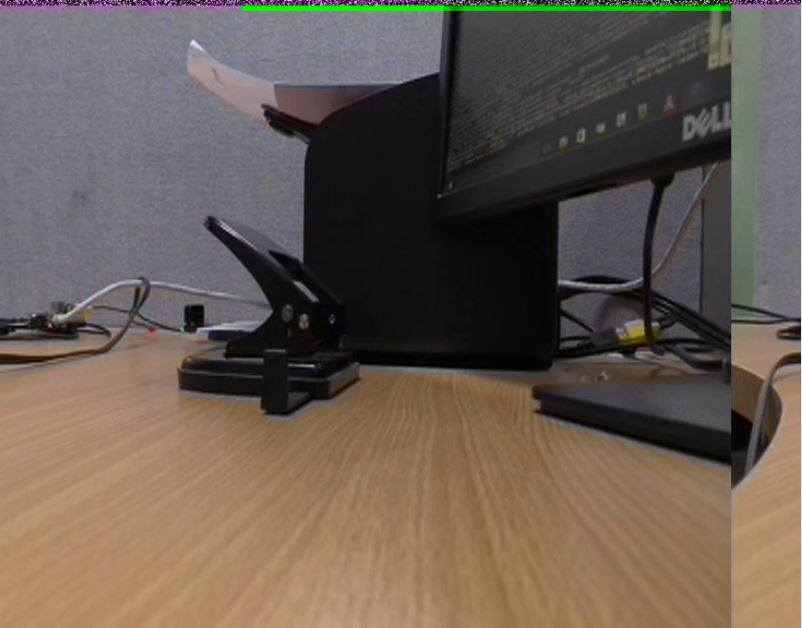

hi there !
i have been trying to run H.264 encoder with leopard imaging board LI-TB02 using DM368 with ridgerun demo image for TVP5146 composite input.
here is my gstreamer pipeline
gst-launch -v v4l2src input-src=composite chain-ipipe=true always-copy=false queue-size=6 ! 'video/x-raw-yuv,format=(fourcc)NV12, width=736, height=576' !
dmaiaccel ! dmaienc_h264 targetbitrate=6000000 bytestream=true copyOutput=false single-nalu=true encodingpreset=2 entropy=0 intraframeinterval=14 idrinterval=10
ratecontrol=2 ! rtph264pay ! udpsink host=199.200.15.61 port=6666 sync=false enable-last-buffer=false
getting reasonable delay and acceptable quality but a small portion of video (approx 80 to 100 pixels) of left side of the image are shown on the right hand side.  image and
video attached for illustration.
here is the video
i wrote the video to a file and played the video on vlc but same results,
i am using sdp file with vlc to stream the video on windows pc.
sdp contents are as under:-
o= IN IP4 199.200.15.61
m=video 6666 RTP/AVP 96
c=IN IP4 199.200.15.61
a=rtpmap:96 H264/90000
a=fmtp:96

i  doubt some setting issue with v4l2src or may be caps but not able to figure out, any help will be appreciated.
Asad
