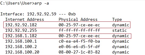

    Attaching Wireshark logs and ARP Table (PC end) screenshot for your reference.
    Please Note:
       MAC and IP of AM335x:
    Eth0 - 192.92.92.182  MAC: 00:25:97:CE:EE:EC
    Eth1 - 192.168.1.182  MAC: 62:46:ed:8e:61:c9
    PC:
    IP - 192.92.92.59 , 192.168.1.59 (Alias IP) MAC- 00:26:b9:22:f6:87

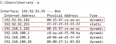

    ARP Table at PC End

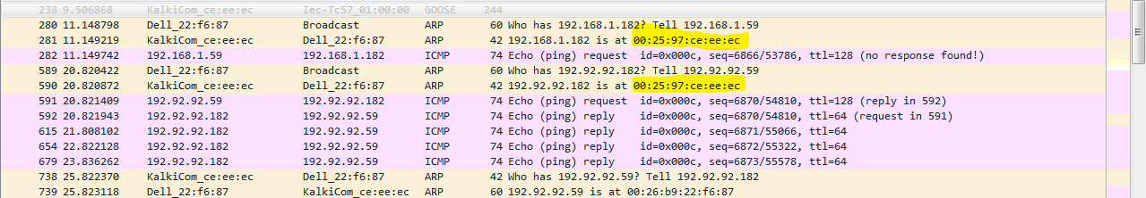

    Wireshark Logs (when connected AM335x eth0 interface to network, eth1 in disconnected state)

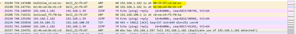

    Wireshark log (eth0 and eth1 connected)
    Smrithy TR
    Thank you for the wireshark capture and the PC ARP table dump. I have not seen this type of issue before except when both interfaces are connected to the same subnet. How are the IP addresses being assigned? When both ports are connected to the same subnet regardless of the port that received the ARP message the kernel always responds on the lower port, eth0 for example.
