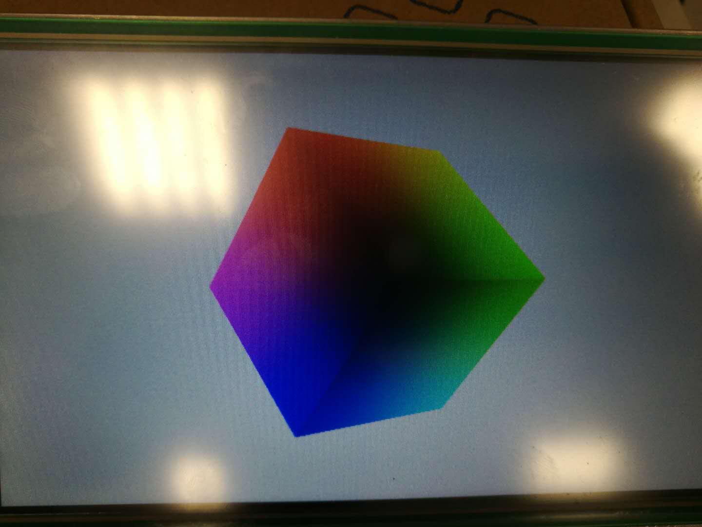

    Could you try to run :
     /etc/init.d/weston stop
    kmscube
    BR
    Margarita

    No.
    kmscube is not gstreamer element it is a graphic demo.
    BR
    Margarita

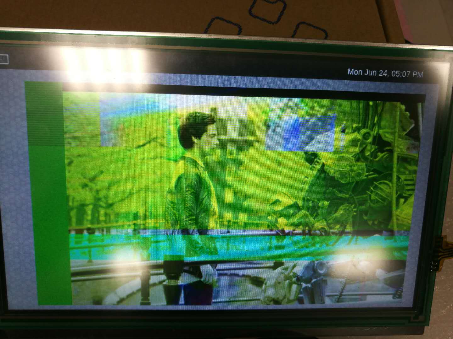

    If use waylandsink, must turn on Weston
    # /etc/init.d/weston stop
    Stopping Weston
    # gst-launch-1.0 playbin uri=file:///usr/share/ti/video/TearOfSteel-AV-Short-720x420.mp4 video-sink="videoconvert ! videoscale ! waylandsink force-modesetting=true connector-id=30"
    The display screen is as follows:
    No. When you run it with weston you must set capsfilter like this:
    gst-launch-1.0 playbin uri=file:///usr/share/ti/video/<path to the file and filename> video-sink=" videoconvert ! 'video/x-raw,format=(string)NV12, width=720,height=420' ! videoscale !  'video/x-raw,format=(string)NV12, width=420,height=240' ! waylandsink"
    BR
    Margarita
  • gst-launch-1.0 playbin uri=file:///usr/share/ti/video/<path to the file and filename> video-sink=" videoconvert ! 'video/x-raw,format=(string)NV12, width=720,height=420' ! videoscale !  'video/x-raw,format=(string)NV12, width=420,height=240' ! waylandsink"
    But it's normal on EVMSK.
  • gst-launch-1.0 filesrc location=/usr/share/ti/video/TearOfSteel-AV-Short-720x420.mp4 ! qtdemux ! mpeg4videoparse ! avdec_mpeg4 ! videoconvert ! 'video/x-raw,format=(string)NV12, width=720,height=420' ! videoscale ! waylandsink
    This command is normal on our board.
