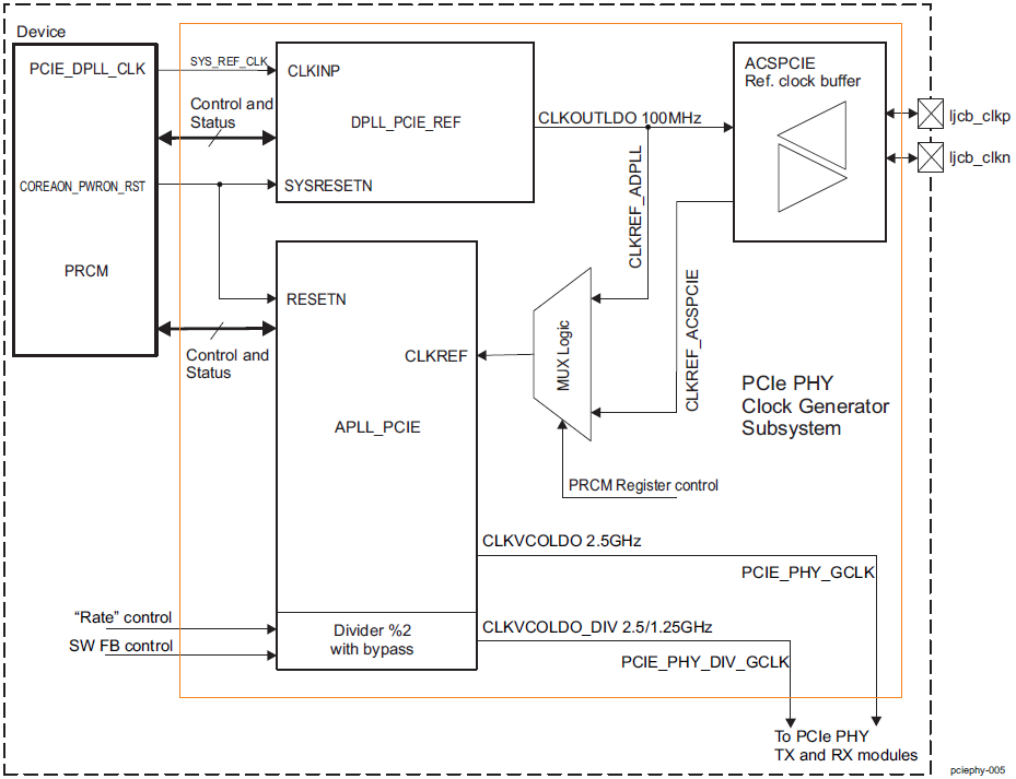

  • Thanks,
    In the pcie_sample_board.c there is a code to select the clock source:
    HW_SET_FIELD(regVal, CM_CLKMODE_APLL_PCIE_REFSEL,
    CM_CLKMODE_APLL_PCIE_REFSEL_CLKREF_ADPLL);
    You may try to see if change to:
    CM_CLKMODE_APLL_PCIE_REFSEL_CLKREF_ACSPCIE);
    helps or not.
    The PCIE link instability under traffic is mostly HW issue (reference clock, board design, etc). I also added our HW engineer for help.

  • Hi Eric,
    I dug into some details of the register programming you asked me to update/check. Found below block diagram in TRM explaining it.
    This is exactly what I wanted. Current programming selects CLKREF_ADPLL, but we need RC to run on CLKREF_ACSPCIE. With this programming update the memory access on the enumerated endpoint runs without any link failures (ran around 3 - 4 times for ~30mins). The suspect now is on, how stable CLKREF_ADPLL clock generated from PCIE_DPLL_CLK and how is the eval-setup (working setup) managing to communicate with CLKREF_ADPLL. But for now this solves my problem.
    I have a few more related questions and will open a new thread for this. Thanks for your inputs and support Eric.
