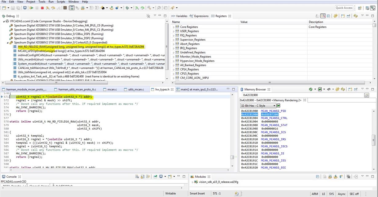

  • Hi Rishabh,
    You can see the snapshot below:
    Bikash

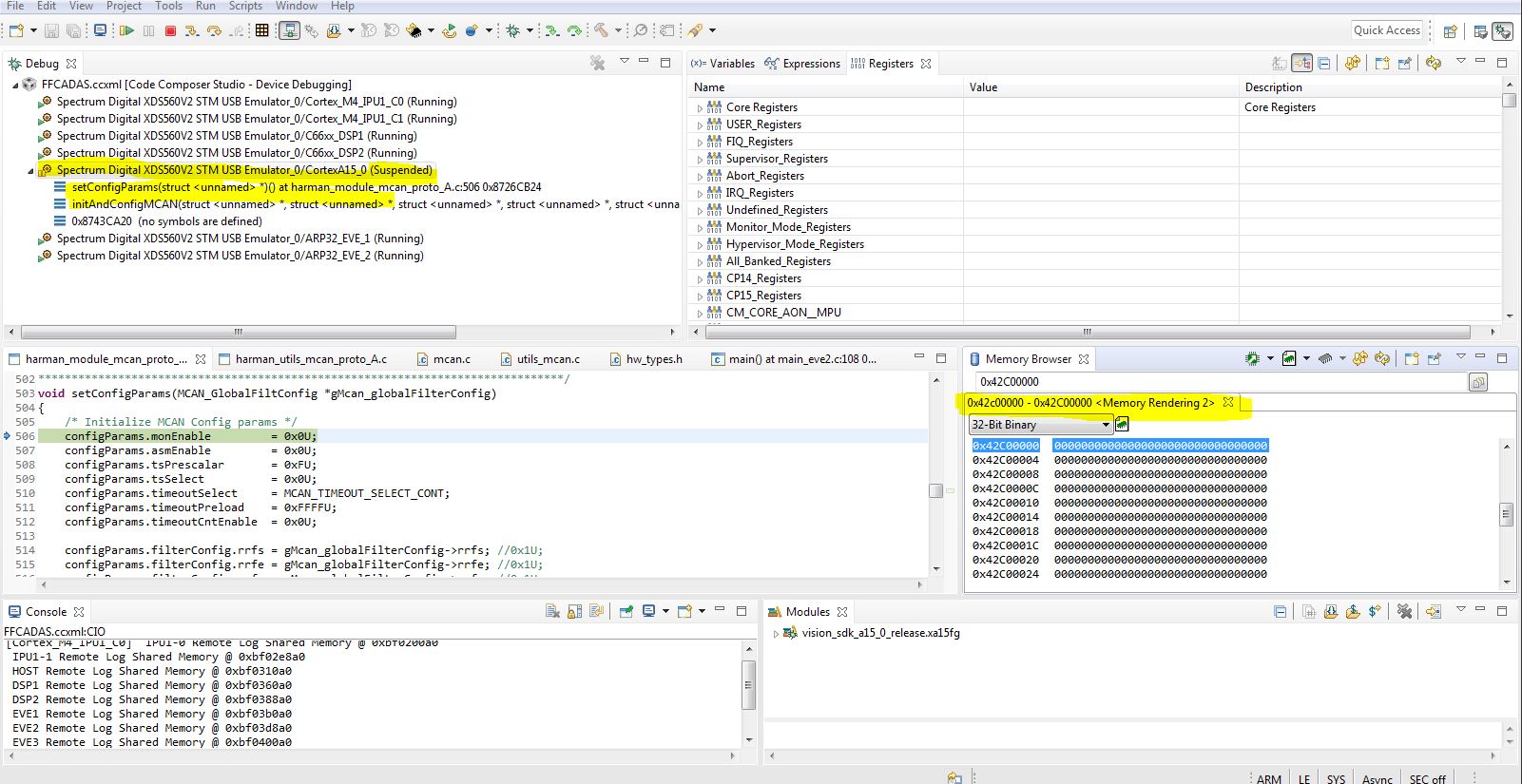

  • Hi Rishabh,
    I guess this is what you are asking for.
    You can see memory region is via A15 when we try to write to mcan registers.
    I can see mcan registers for DSP too in memory window but we are not using mcan on DSP core nor we are making any mcan api call from this core.
    Bikash
  • Hi Bikash,
    Yes I am asking this but you need to read from a different address i.e. register space 0x42C0 1900.
    Rishabh
  • Hi Rishabh,
    You can see memory region is via A15 when we try to write to mcan registers for register space 0x42C01900.
    We are getting exception when we are trying to read the register.
    Bikash
  • Hi Bikash,
    PRCM is enabled as seen from memory window and you are able to read PID via A15 debugger path.
    Have you mapped this space in A15 MMU? Can you share your A15 cfg file.

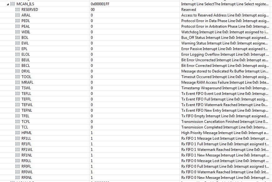

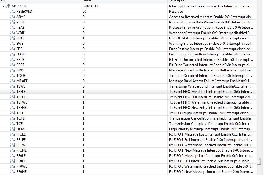

  • Hi Rishabh,
    The exception issue is resolved.
    It was causing due to some mismatch in MCAN address.
    However I can see Can is initialized and we are getting acknowledgement for any RX message we are transmitting through the Canalyzer.
    But we are not getting any interrupt for Rx as well as Tx.
    I can see interrupt Enable register are set,
    I suspect it may be due to Cross bar mapping.
    I have attached the source files please have a look and let me know if the mapping is correct.

  • Hi Rishabh,
    I have attached Screen shot for MCAN Interrupt enable register:
    Bikash
