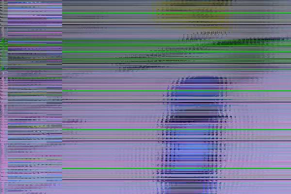

I am using DRA752 CPU on D3 TDA2x setup with OV10635 LVDS Camera. I am new to this, I tried to change the resolution from 1280x720 to 600x400, But I am getting distorted image, unable to capture & display proper image.
* I got register settings from OVT for 600x400 (YUV422 & PCLK=24MHz).
* Changed the register values in BSP LVDS Structure.
* Changed 600x400 in Capture link and Display link.
* Written usecases for 1) Capture->Display to display 2) Capture -> Null(A15) to dump.
Then, I run application to capture & display as well as capture & dump, But, i am getting distorted image in display and dump both.
OVT Suggested, Receiver need to set resolution (image size) properly. Please check if the resolution (image size) setting is correct or not.
Is anywhere, am i missed to set the resolution in visionSDK 3.04?
I am using only VIP capture Link. I am not using SGX / Encoder also, So I changed in VIP Capture Link and usecase. Is there anywhere i missed ?
