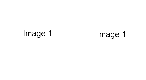

  • Hi Bernie,
    I attached image for your reference. In that image It has the single frame. I am getting video frame in same manner on display device(TV). I am trying to do CIF upscaling to D1.
    Please let me know if you need more details.
    Dilip

    If I do only Y data resing then getting dual image. I dumped the data before giving to display driver and analyed using YUV analyzer and I observed the CIF->D1 conversion outputs dual image after resizing call. I verified the input data also I contains the CIF image only and proper video data.
    Please advice me how to resolve this issue.
    Dilip
  • Based on your dual image it appears that the vertical aspect of the resizing is working properly and that only the horizontal is somehow being duplicated, is this the case?
    I am looking to see if we have some example that would suit this situation, but in the mean time could you post your resizer register settings/configuration?
  • Hi Bernie,
    Thanks for response.
    Yes, Your understanding is correct.
