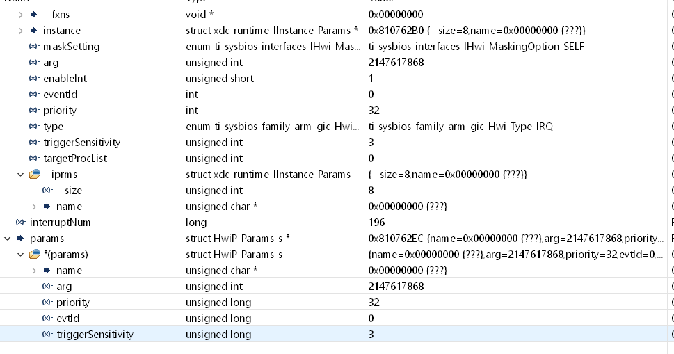

    I have been trying to debug your code using K2G EVM platform and have been comparing the TI UART driver interrupt setup with your driver but there are a few issues with your code.
    If I enable TEST1 or TEST3 that should output on the K2G debug UART, there is no data observed on the serial console on the host with either test cases. Our evaluation platform uses the same T1 and T4 pins as your board so I expected the binary to work. Have you tested this code on the TI evaluation platform?
    Your code doesn`t use board library where we have consolidated approach to configuring PSC/Pinmux etc which makes things easy to follow. If case of your code, we need to go and validate every SOC register configuration impact UART which is time consuming.  This is reason why it is not reasonable for us to  support custom driver development on a custom platform.
    Thus far I have been able to check that the Pinmux, PSC and UART registers are set correctly and the CSL for interrupt setup (using CSL_armGicConfigIntr) gets called the same way as TI UART driver.
    Custom UART setup with CSL_armGicConfigIntr
    UART configuration
    ARM interrupt configuration
    TI UART driver on K2G EVM:
    Can you please try to provide clear instructions on how we can reproduce this on the K2G EVM. Given the base code doesn`t print anything on UART0, I am not sure if the driver code is functional with one instance of UART on the TI HW platform.
    Rahul
